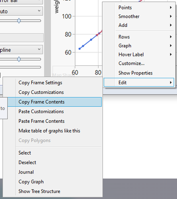

11) copy and paste Frame content in Graph Builder (to overlay different plots)
