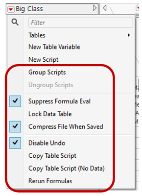

18)
most of the actions in the table context menu are not recorded:
