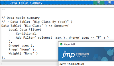

8)Local Data Filter on the Tables/Summary platform
(new feature in Jmp 17)
(view in My Videos)
-> fixed with v17.1 :)
now the Data filter shows up in the log:
