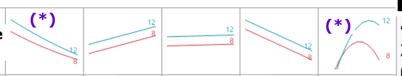

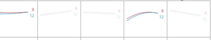

In the first screenshot(1-No_distinction) I've  manually indicated the terms included in the model with asterisks (*).
JMP did not distinguish the display of the panels based on inclusion of factors.
In a different JMP workbook the plots corresponding to factors not included in the model are dashed lines and appear with dimmed intensity (2-With_distinction).

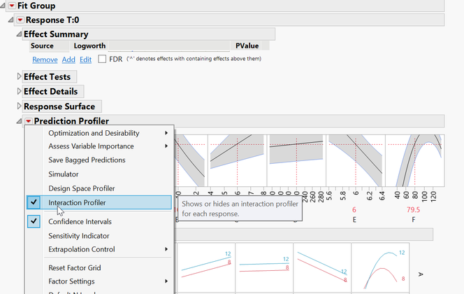

I believe to have uncovered the source of the inconsistency. I have reproducibly generated the following outcomes:

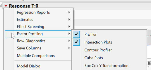

Outcome 1: Gray-out display properties as desired:
Interaction Profiles must be “requested” in the JMP dialog via the drop-down for the Response as shown in the screenshot cursor:
Outcome 2: Gray-out display properties are not implemented, leading to inconsistency with respect to the terms included in the model:
Interaction Profiles are “requested” in the JMP dialog via the drop-down for the Prediction Profiler, a sub-item of the Response.
In the screenshot for Outcome 2, it the AC AD AE plots are not grayed out.
In fact, both modes of Interaction Profile panels can be displayed simultaneously.
In summary to have the gray-out/dashed line display consistently dependent on the inclusion of respective interaction terms in the model the Interaction Profile panel apparently must be activated from the Factor Profiling menu for the Response.

I may not understand your situation, but JMP will only give plots for the terms in the model.  If terms are confounded (aliased), then you will get dashed lines to indicate this.
capr
Level II
Re: Interaction Profiles - automated display of panels based on factor inclusion
Thank you. In the top example, the three plots without asterisks are for interaction terms not in the model. Yet, they are not displayed in dashed lines. Could  you please elaborate on the aliasing of terms?

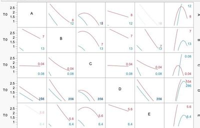

If, for example, you run a fractional factorial design and do the analysis with a saturated model, the interaction plots will show dashes indicating there are aliased terms.  Here are the interaction plots from a 2^4-1 res IV experiment.  Since 2nd order effects are aliased, you see the dashed lines for the aliased interactions.

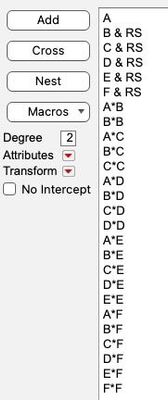

If you look at the Model it appears all 2nd order factor interactions are in your model.  Hence you will see the interactions.

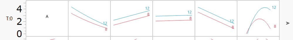

If I modify your model with just AB and AF, this is what you get:

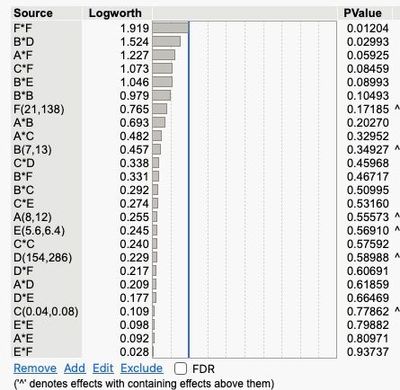

Thank you! in response - can you please address why A*C-E do not appear in the Effect Summary?
What I have intended in the model derivation/analysis was to include these terms initially, but then they were eliminated based on significance/contribution.
In other  work, eliminated interaction terms not appearing in Effect Summary  are grayed out/dashed in Interaction Profiles.
statman
Well if I wager a guess it's because you removed them.  Here is the effect summary with your model (except I removed the D*D since it was aliased) before any terms are removed:

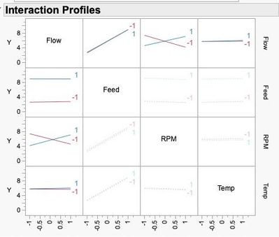

I'm not sure what exactly you are doing, but I removed AE from the Effects Summary and here is the Interaction Profile.  Notice the AE interaction is greyed out.
