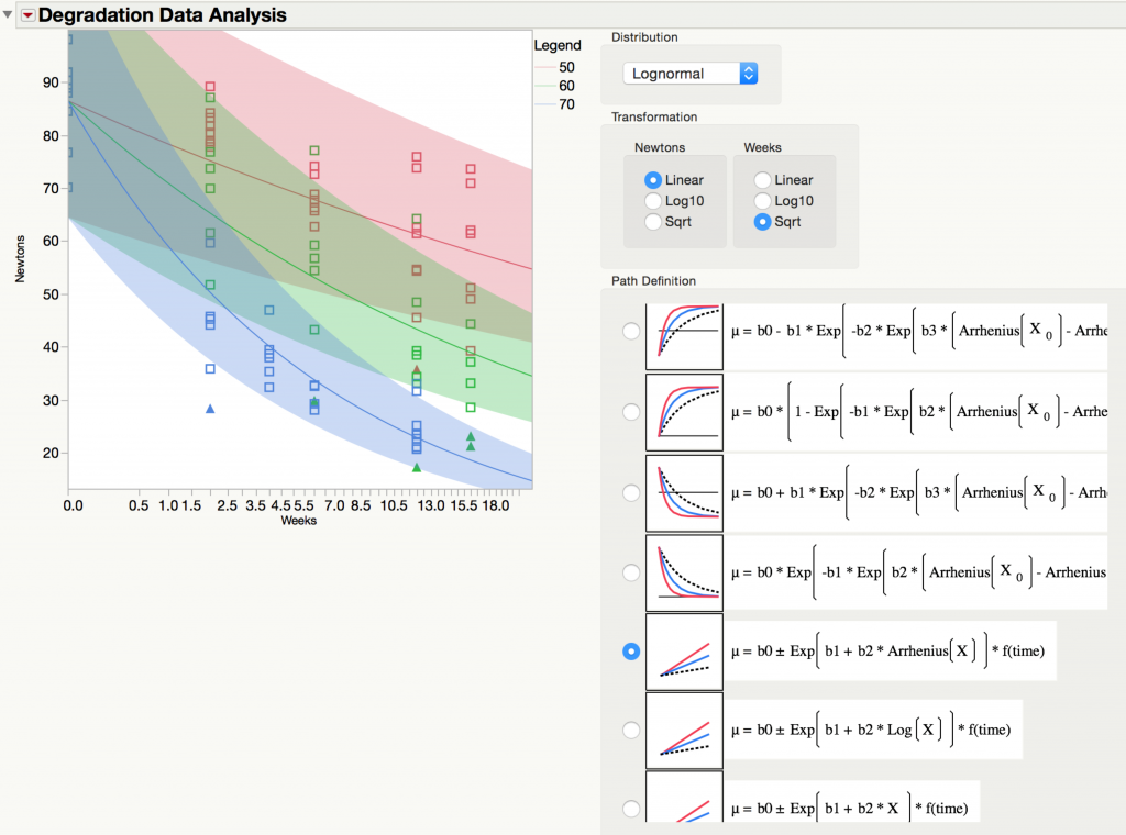

The Destructive Degradation platform allows you to fit a model by selecting from a list of 1) a predefined models that include built-in starting values, 2) data distributions and 3) common transformations with improved ease and efficiency.
After selecting the desired model from a pre-built list of models in the “model library” known as the Path Definition, you can visually compare the path style shape examples associated with each model type to the degradation plot to assist in selecting the best model based on the expected behavior. Multiple models may be generated for comparison, altering the underlying distributions and transformations. To determine the best statistical fit, you would then use the model comparison criteria, AICc or BIC.
Destructive_Degradation_JMP

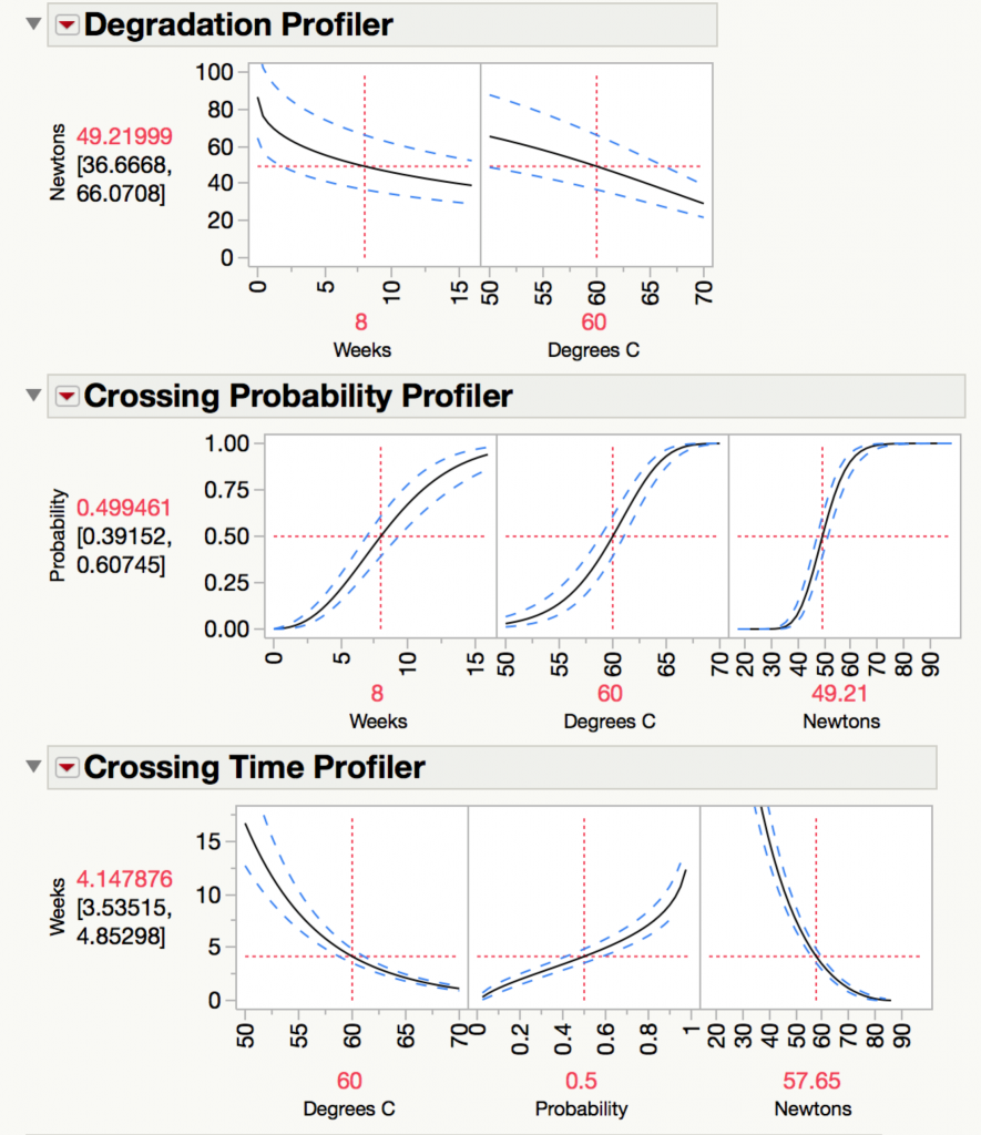

A new suite of Prediction Profilers is available so you can perform evaluations and what-if analysis on degradation, crossing times and crossing probabilities. All Profilers include confidence intervals.
Destructive_Degradation_JMP_3
