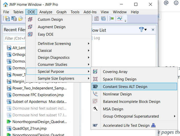

Our new capability, Constant Stress Accelerated Life Test (CSALT),  uses experiment design principles to determine the number of units to test at a variety of stress levels to obtain failure data that can be used to predict reliability under normal conditions. It is a new option under Special Purpose on the DOE menu.

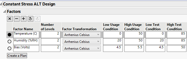

Users interactively specify details for up to three accelerating factors for an ALT test. Next, they specify the characteristics of the ALT test plan. These characteristics include model assumptions. Then, JMP generates three alternative plans to consider. Users choose a plan and then simply press a button under the desired plan to make a data table for data collection. After the units have been tested and the data collected, users can proceed to use the table script to build a model for lifetime prediction.

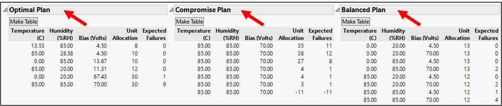

CSALT generates three test plans automatically. Why three?
Users have specific resources and goals, so having three plans gives them options. The Optimal Plan optimizes the large-sample approximate variance of the quantity specified in the plan settings. It typically has the fewest test settings and is the most dependent on the validity of the assumed model. The Compromise Plan also attempts to optimize the large-sample variance, but with the additional constraints of a mid-point test setting with a minimum proportion of units allocated to that setting. The Balanced Plan places units at every combination of test settings, based on the number of levels per factor provided by the user. It typically has the most test settings.
Constant Stress ALT Design is a new option on the DOE Special Purpose DOE Menu.
Users identify up to three acceleration factors to include in their accelerated life test plan.
Users specify the details and model assumptions for their accelerated testing.
JMP generates three test plans, or designs, for the specified factors, distributions, number of units, and model assumptions.
