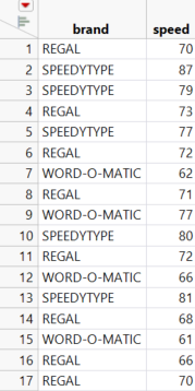

Today’s example involves three brands of typewriters (Regal, Speedtype, and Word-O-Matic)  that were tested for typing speed. There are two columns in this table: brand and speed. The table can be downloaded if you want to follow along; it’s an attachment to this blog post.

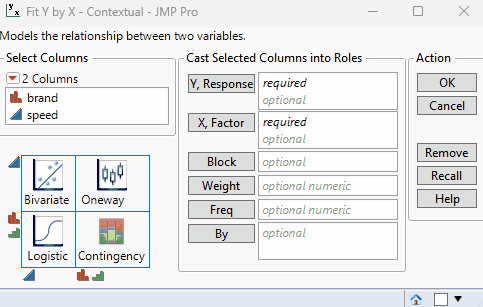

To perform a one-way ANOVA, start by selecting the Fit Y by X option under the analyze menu. Next, drag-and-drop click the continuous response variable (in this case, “speed”) to the Y role and the categorical factor variable (“brand”) to the X role. Click OK. The report initially contains a scatter plot of speed vs. brand.

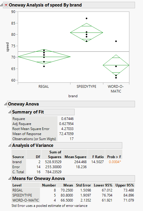

Click the red triangle, then click Means/ANOVA. The report now includes mean diamonds in the scatter plot, a summary of fit table, an ANOVA test with a p-value, and summary statistics for each group.
The line at the center of each mean diamond represents the group mean, and the vertical span represents the 95% confidence interval for the group mean. From a quick look, you can observe that the mean of Speedtype is noticeably higher than the other two brands. The ANOVA section shows a statistically significant p-value of 0.0004, meaning we can reject the null hypothesis that all group means are equal.

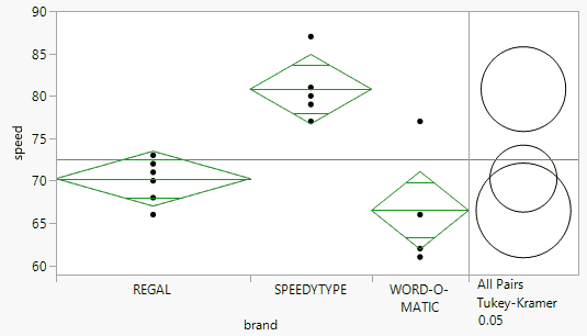

The report now includes comparison circles to the right of the initial scatter plot. These circles provide an interactive visual representation of group mean comparisons. Circles for significantly different means do not intersect or very slightly intersect. Click the circle associated with the Word-O-Matic brand and observe how both it and the Regal brand are highlighted in red. Red circles correspond to groups with means that are not significantly different. The Speedtype circle is gray and does not intersect with the other two brands’ circles, which signifies that the Speedway mean is significantly different from the highlighted group of Regal and Word-O-Matic.

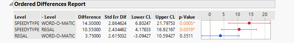

For more quantitative results, scroll down to the Ordered Differences Report, which shows the difference between the levels of each comparison, the standard error of the difference, the confidence interval, and the p-value.
Note the p-values for the difference between Speedtype and Word-O-Matic and difference between Speedtype and Regal are highlighted in orange. Since they are both well below 0.05, it means that these differences are statistically significant, which matches up with the visual representation of the circles above.
