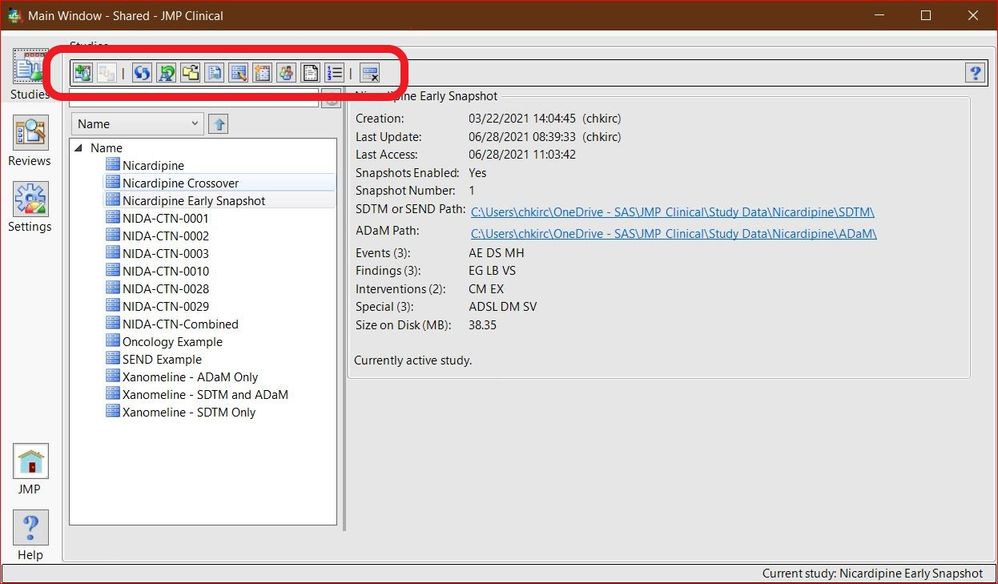

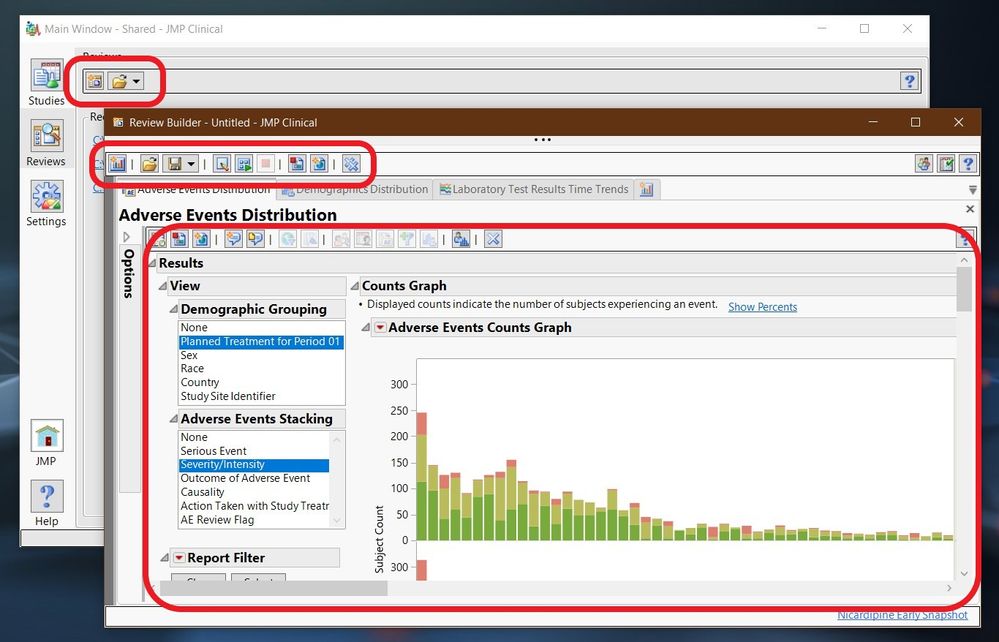

For this post, let’s start with the two main categories and what is possible. The two main categories are: Study Management related functions (JMPClinicalStudyManagerAPI) and the Review related functions (JMPClinicalReviewAPI). The idea is to replicate what can be done within the user interface (mainly the button clicks) where user a decision is not needed (like refreshing the metadata for Studies with new data or opening a Review Template and running it for a specific Study). Below are a couple of images that highlight buttons that relate to the Study Management section and the Review section.
Study Management Functions that Relate to JMPClinicalStudyMangerAPIStudy Management Functions that Relate to JMPClinicalStudyMangerAPI
Review/Review Builder Functions that Related to JMPClinicalReviewAPIReview/Review Builder Functions that Related to JMPClinicalReviewAPI
The API is meant to take routine tasks and automate them, like refreshing studies with new metadata or to add/remove content from a Report within a Review Template. Here is a link for the JMPClinicalStudyManagerAPI functions and another link for the JMPClinicalReviewAPI functions for reference.
