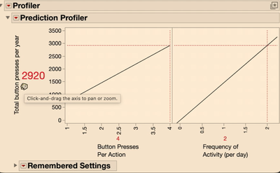

Profiler
change factor settings Alt + click into one of the profiler graphs

Specify or lock a factor value in the Prediction Profiler. Press Alt and click inside one of a factor’s panes.

Lock a factor (in a profiler) Press Alt and click into the respective plot, then select Lock Factor Setting hogi_4-1673821177582.png

cool motivation from @jules / Everyday Efficiency:
[a link to the plenary talk is in the main post]
How many clicks are required, and what is the typical frequency per day?
This is an area where efficiency can be increased significantly, e.g. by reducing the number of clicks from four to one.
Not every click is equal: for example, to open the control panel in Graph Builder, you have to click, move the mouse and click again.
To hide or show the legend, you have to click on the red triangle, in the right click menu that pops up, you have to find the submenu "show" and open it -  and then click a third time on "Legend". So, as well as mouse clicks, precise mouse movements are necessary.
The number of clicks is one thing, but the frequency per day is another factor. Many JMP users close and open the control panel and the legends dozens of times a day. This is a huge lever!
This finding triggered the development of the GraphBuilder Toolbar  - with its two first shortcuts *):
just try it out and track your time savings ....
*) After several years of development, there are now many more icons in the toolbar - try them as well and give feedback: Graph Builder Toolbar
