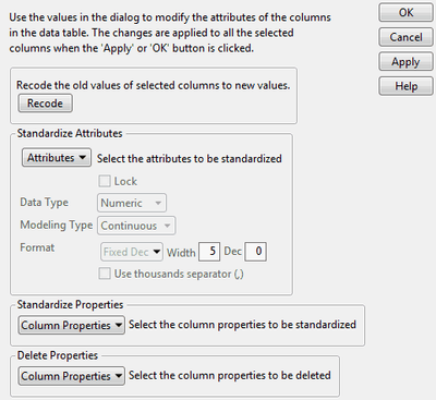

5. Standardize Attributes
As data tables get larger with more and more columns, you'll appreciate a way to change the data types, modeling types and properties for lots of columns all at once. That what Cols -> Standardize Attributes​… does.
Just select all the columns that need to be changed and then launch Standardize Attributes….
This makes it easy to change data that may have been imported as Character columns to Numeric. Easy peasy!
Bonus: Don't miss the Recode option at the top of the dialog. Clean up a bunch of columns all at once!

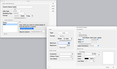

7. Axis property
Emerson may have appreciated a bit of inconsistency, but you may want the axes that are the same every time, regardless of the range of the data. The Axis property of a column lets you set the axis exactly the way you want it, and JMP will use that whenever that column appears on a graph.
You may find it easier to set up an axis the way you want it using an existing graph and the save the axis settings to a column property by right-clicking on the axis.
