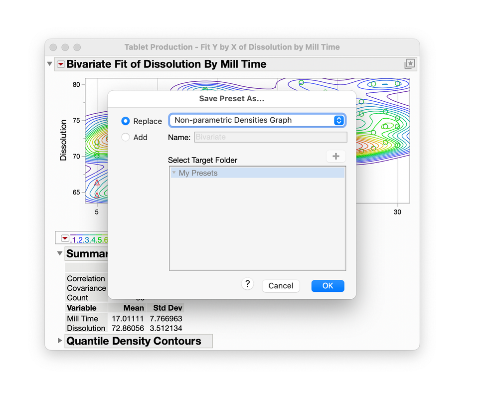

Go to the preset menu and select Save Preset As…. I’ll give it a descriptive name, Non-parametric Densities Graph, and click OK.
Screenshot 2024-02-02 at 9.49.54 AM.pngScreenshot 2024-02-02 at 9.49.54 AM.png
This platform preset is now available to use under the My Preset menu; it is available any time I use the Fit Y by X platform with these types of columns.
Suppose after making this preset I realize I also wanted to include summary statistics. I can add that table by going to the red triangle > Summary Statistics. Then, I simply update the preset by going to the presets menu and selecting Save Preset As. After making sure Replace is toggled and my saved preset has been selected, I click OK.

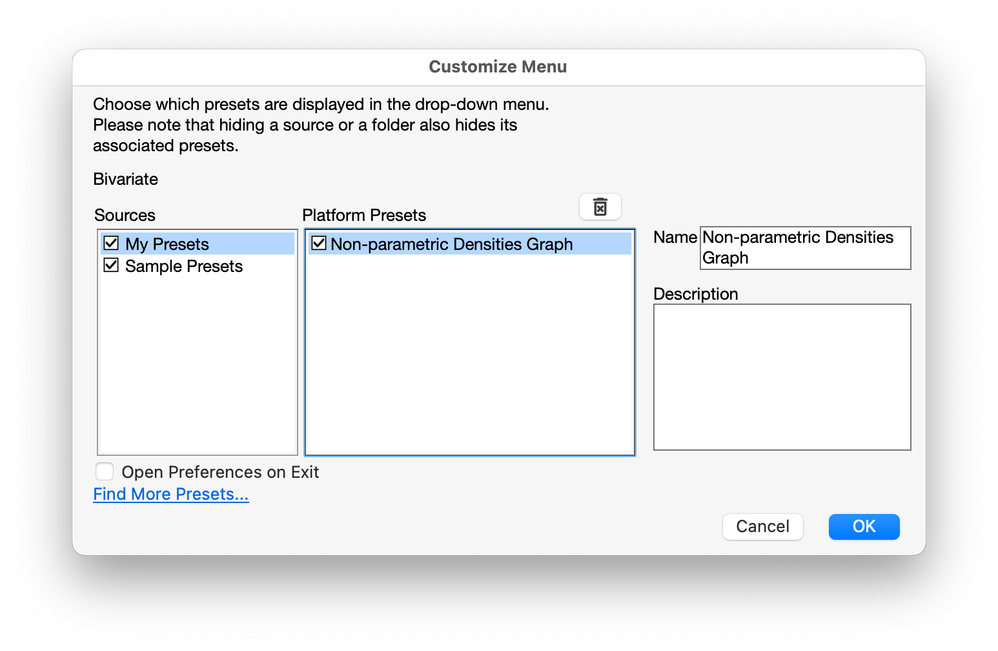

To rename, delete, or hide presets, select the Platform Presets menu > Customize Menu…
To rename a preset you have saved, select the preset and change its name. If you wish to hide but not delete the preset, you can uncheck the box next to the preset and it will not be shown in the menu. You can also hide entire preset sources, such as hiding all the Sample Presets from the menu by unchecking the box next to Sample Presets. If you’re anything like me, you might end up with a large number of presets you want to organize. You can right-click to group and ungroup presets, which will create corresponding submenus in your Platform Presets menu.

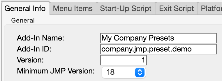

If you intend to deploy presets across your organization and don't want those presets to be intermingled with user presets, creating a Platform Preset add-in is the right way to go. To begin, go to File > New > New Add In.
First, provide a name and ID for the add-in.

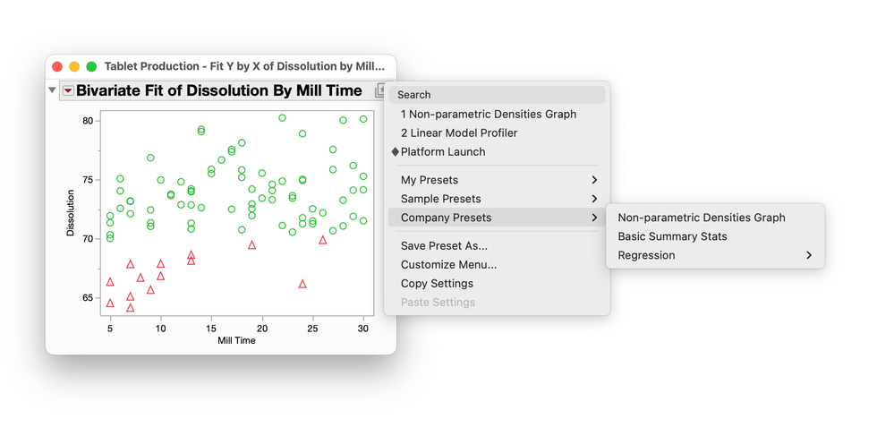

Now, navigate to any platform that had a platform preset installed by the add-in. In this case, I've gone to Fit Y by X, and set up the platform to give Bivariate output. To do that, select a continuous Y and a continuous X; hit OK.
When you look under the Platform Presets menu, you will now see the “Company Presets” submenu, which contains all the presets we included in this add-in.
