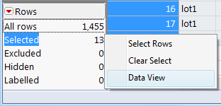

  3. Data View. Especially when working with large data, I often use the Data Filter or other methods to explore. When I need to view a quick subset, I use the Data View. With some subset of rows selected, right-click on the "Selected" item inside the Rows pane (lower left corner) in your data table. You'll see a submenu; choose Data View. A new table displays with just the subset rows showing. For additional fun, this is a linked subset, which means that any change you make in this subtable will also occur in your main table. I find this super-useful for managing my large tables.
