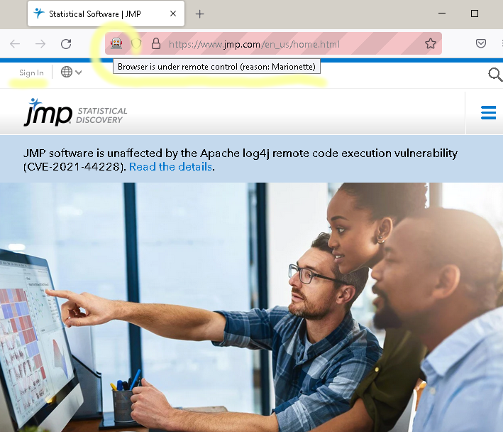

The nav function returns "ok" or an error message. The JMP web page loads in the browser. Ignore the people in the screenshot.
The icon means the browser is remote controlled.The icon means the browser is remote controlled.
Script the sign-in to the JMP site. Right-click the Sign in button to find out the button's HTML id value. Remember how to do this; I'll skip this explanation at the end...

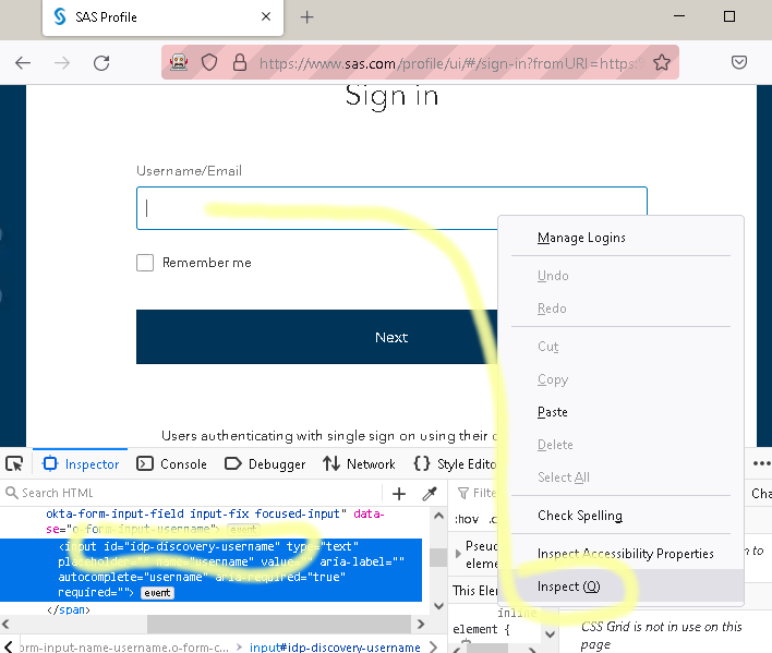

Cool! The sign on screen pops up. Find the user name field next.
Now get the id for the user name field by right-click...Now get the id for the user name field by right-click...
Again, wait for the expected field. Now a keystroke function is needed...

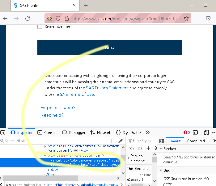

My userid is scrolled off the screen and the next button is visible...find its name...
Click the Next button to get the password prompt.Click the Next button to get the password prompt.
click it, then wait for the password field...

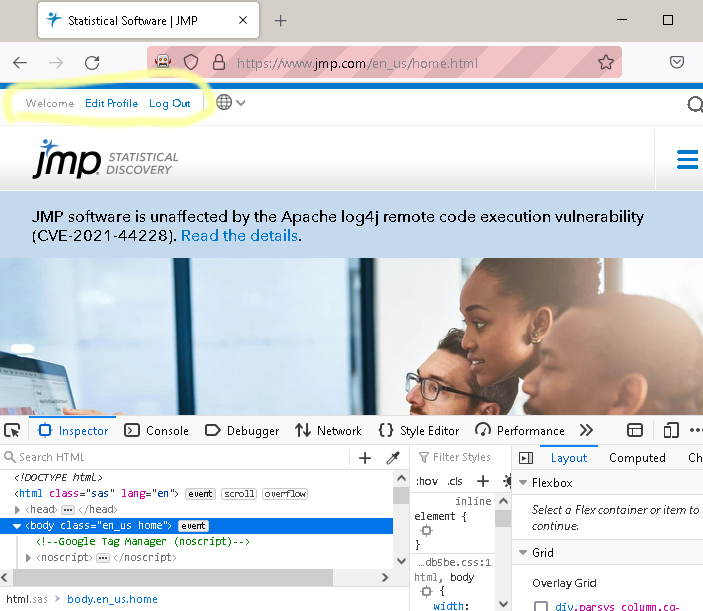

We are signed in.
Must be signed in, there is an edit profile choice.Must be signed in, there is an edit profile choice.

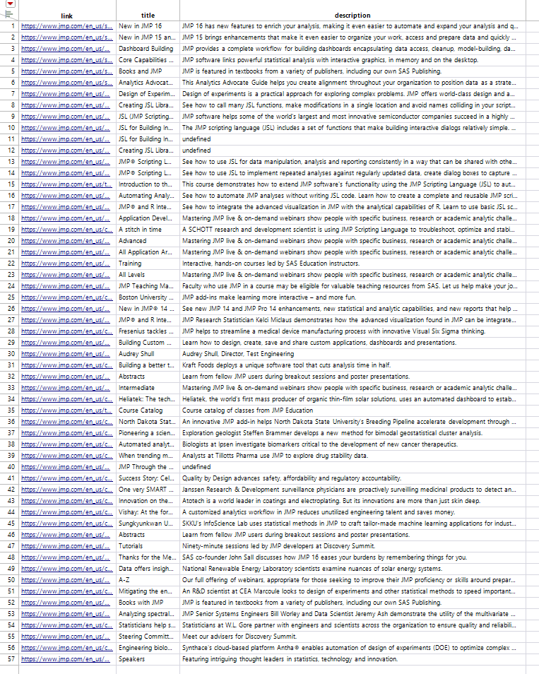

Above: some functions to use in the loop below. There are buttons at the bottom of the page to go to the next page; they run some JavaScript that destroys and recreates the list of items. The functions are called again to recapture the new list. The JSL and Python are good enough for this example. They will break down if there is more than one list to keep track of at the same time--see the Python list variable. I'm pretty sure it is necessary to wait for the data to load after each next page...
dt = New Table( "articles",

At this point the browser is open and this table is on the screen.
Today there were 57 entries spanning three pages.Today there were 57 entries spanning three pages.
