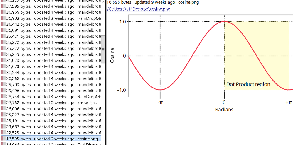

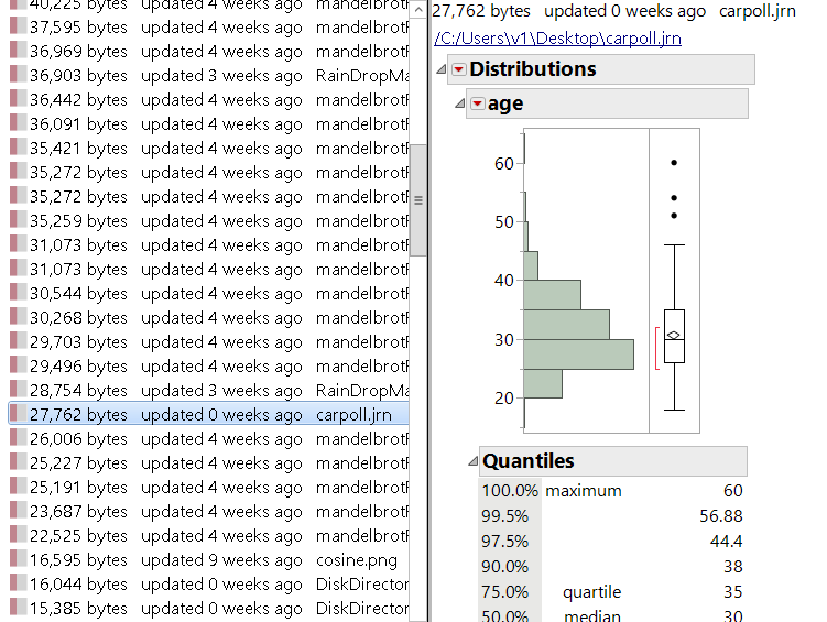

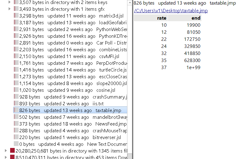

The TreeClickHandler opens a simple viewer for a few file types.
    // click handler for tree nodes
    treeClickHandler = Function( {thistree, thisnode}, // a few viewers for common file types
        {extension, data, tablename, nodedata, nodelabel},
        nodelabel = thisnode << getlabel;
        nodedata = thisnode << getdata;
       // show(nodelabel,nodedata);
        line1 << settext( nodelabel );
        line2 << setbuttonname( nodedata );
       // show(line2<<getbuttonname);
        Try( (view << child) << delete, Show( exception_msg ) );
        extension = Regex( nodedata, ".*?([^\.]*)$", "\1" );
        If(
            Contains( {"png", "jpg", "jpeg", "gif", "bmp"}, Lowercase( extension ) ),  //
                view << append( New Image( nodedata ) );//
        , /*else if*/
            Contains( {"txt", "jsl", "csv"}, Lowercase( extension ) ), //
                data = Load Text File( nodedata, blob( readlength( 2000 ) ) );
                If( Length( data ) < 2000, // arbitrary limit, here, and above
                    data = Blob To Char( data )
                    data = Blob To Char( data ) || "\!n\!n✁✂✃✄\!n\!ntruncated\!n\!n✁✂✃✄\!n"
                view << append( Text Box( (data), <<setwrap( 1000 ) ) );//
        , /*else if*/
            Contains( {"jrn"}, Lowercase( extension ) ),  //
                view << append( Journal Box( Load Text File( nodedata ) ) );//
        , /*else if*/
            Contains( {"jmp"}, Lowercase( extension ) ),  //
                tablename = nodedata;
                If( File Size( tablename ) < 1e6, // arbitrary limit to prevent slow down, here and below
                    dt = Open( tablename, invisible );
                    view << append( Journal Box( Data Table Box( dt ) << get journal ) );
                    Close( dt, nosave );//
