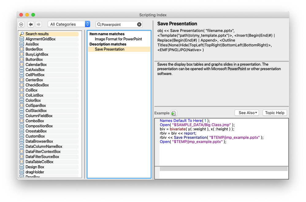

The Scripting Index
Open up JMP and go to Help > Scripting Index. Congratulations! You just accomplished one of the most important tasks for learning JSL. This one tool has got me out of more jams than I care to mention. Every scripter I know has this open during a serious coding session. Every. Single. One. Just get used to having it open.
It is the collected knowledge (with examples!) of the JMP developers. It’s updated every release with any changes to JSL or new commands for new platforms in JMP. Why is this so important? Unless you’re scripting all day, every day, there no chance that you will know everything about JSL. This tool fills that gap.
Here's a little example. Open up the Scripting Index, and type "powerpoint" in the filter field. The bottom entry in the second column says "Save Presentation." This gives you the form of the command export a report as a PowerPoint File and an example of how to use it.

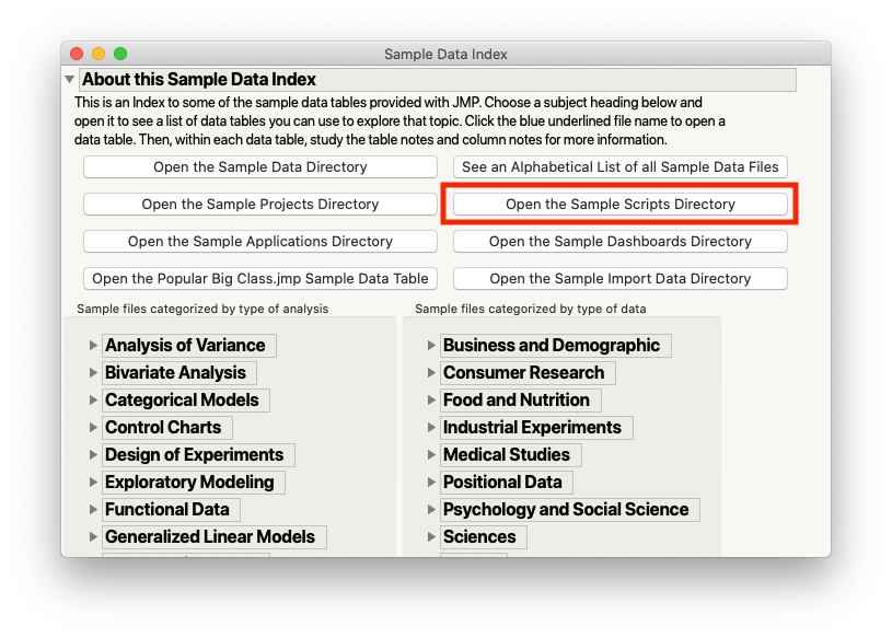

JMP Tutorials and Sample Data
Now, in JMP go to Help > Sample Data. Note the buttons along the top of the interface. One of them says, “Open the Sample Scripts Directory.”
Guess what’s in there? Examples of completed scripts! If you want to know how to get a script to add a formula column to a data table, there’s an example in there. If you want to know how to get JMP to connect to an external dll file, there are a few examples in there. There is nothing wrong with starting from these scripts or using them as templates when you are getting started! That is why they are there.
