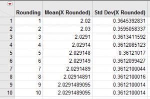

It is usually best to examine any continuous variable and determine a reasonable precision for the recorded values. For instance, suppose I have a variable X, and X has the values shown in the table below:

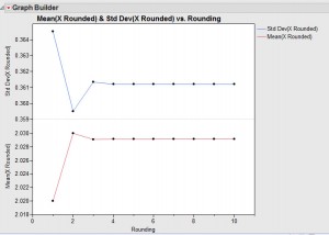

The data is recorded to 10 decimal places. But if we are analyzing this data, do we really need that many digits to the right of the decimal? One way to examine this is to look at the plot of the estimates of the mean and standard deviation of this data, as a function of the level of rounding used. A good question to ask is "How sensitive are the summary statistics to the level of precision?"

The table and the chart show that we don't lose very much information in the estimate of the mean even if we round all the way to one decimal place. A good rule of thumb about the needed precision for a variable is to divide the standard deviation of the unrounded data by 3, and use the leading significant digits decimal place as the level of rounding. In the example shown here, the standard deviation of the unrounded data is 0.3612, so 1/3 of that is 0.12, indicating that one decimal place is sufficient.

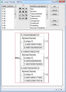

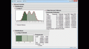

Consider the slightly "lumpy" variable shown in the histogram below. A Normal Mixture distribution using 3 normal distributions is fit to the data (Hotspot>Continuous Fit>Normal Mixtures>Normal 3 Mixture). The parameter estimates from the mixture distribution are recorded, and a binning formula is created that assigns a row to a group based on which distribution in the mixture the row has the highest associated probability.
The binned variable is an integer that preserves the ordering in the data, so it can be used as a continuous, ordinal or nominal variable.
Click image to see animated version
To automate the process of using normal mixture distributions for unsupervised binning, I created a JMP add-in (available for download on the JMP File Exchange -- requires a free SAS profile).
