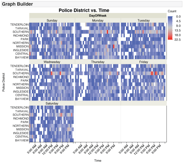

Finally, I wanted to know more about when incidents occur. Again, I used Graph Builder, this time to make heat maps based on time, date and precinct. The heat maps provide a great overview, and they would be a helpful tool for staffing and force planning. At first, I was a little surprised that 6 pm is a high crime time in downtown San Francisco, but then I realized that is when everyone is out and about − including me!
Heat map of San Francisco crime data by district, day of week and hour.

Thank you for the compliment! JMP does have the ability to use a Web mapping service (WMS), although I did not use one for this example. I could have used the NASA server, for example, but that doesnâ t have streets. I also wanted the map (which is just a background picture) to be saved as part of the script so there is no other file to refer to. John Ponte, one of our great JMP developers, helped me out getting the background map by using an online ESRI source to get some map tiles. I used scripting to align the background picture (the street level map) with the x, y coordinates (which is the x and y axis in the graph).
