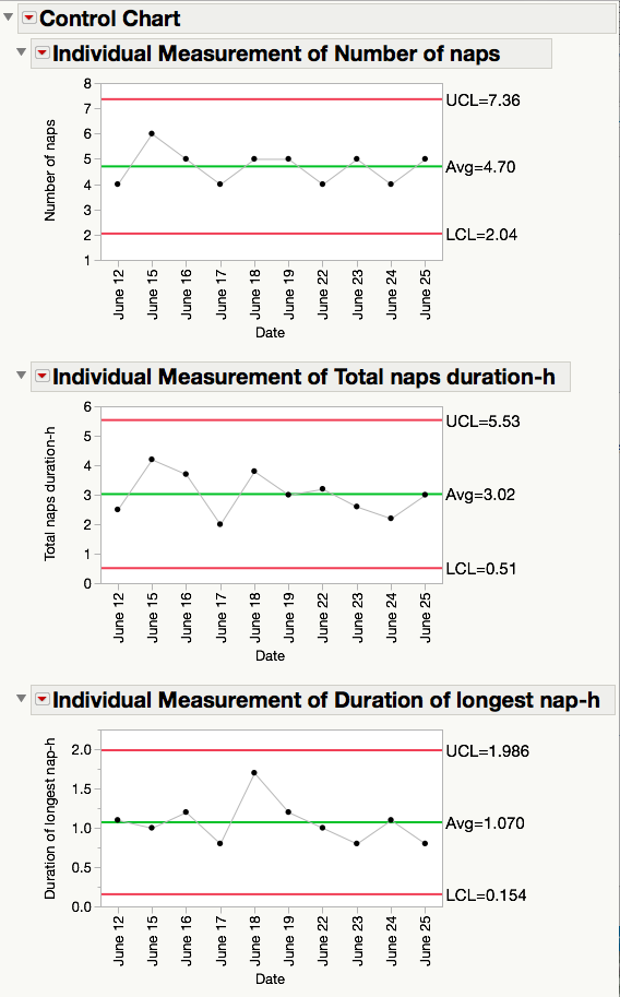

    She even has success to report for her “generation II” implementation for her now 8-month-old son’s feeding and sleeping schedule for his first weeks in daycare. These are Inna's control charts below:
    Screen Shot 2015-11-17 at 1.49.27 PM
    Screen Shot 2015-11-17 at 1.47.44 PM
    They called him a cat-napper in daycare, and we can see why. We can also see that the first day of daycare, he went on a hunger strike, but then his appetite took off on subsequent days. It looks like her son's transition to daycare was successful, but kudos to Inna for collecting some data "just in case" there were any issues.
