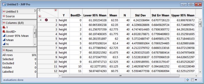

2. In the Bootstrapping window, click OK. JMP creates a data table (below) with statistics for the original sample in the first row (excluded) and each of the bootstrap samples. The BootID• column identifies the bootstrap sample number.

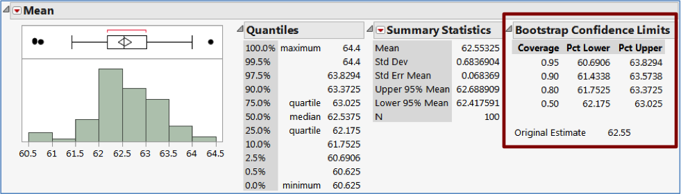

3. Use the Distribution platform to explore the statistics of interest for the bootstrap samples. Bootstrap percentile confidence intervals for different confidence levels are provided.
