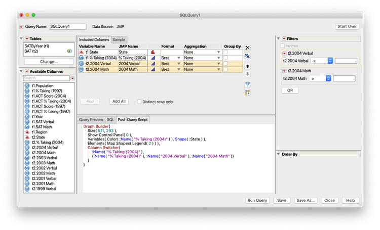

image081.pngimage081.pngNow, that’s a lot of clicking around for a graph and a very common view for this kind of data. Using our new scripting skills, we can have Query Builder reproduce this graph (and any additional ones we may choose to add later). Here’s how you do it:
  1. Select Save Script > To Clipboard from the Graph Builder.
  2. In the Query Builder select the Post-Query Script tab in the bottom half of the window.
  3. Paste (CTRL+P for PC or CMD+P for MacOS) the script into the Post-Query Script tab.
  4. Save the Query Builder file by clicking Save.
  5. Now, close the data table Query Builder created and Graph Builder.
  6. Click Run Query.
See how that works? By using Query Builder, you got some interactivity for free in the form of the filtering dialog and were able to significantly increase the efficiency of this workflow. If someone had the two data files, you could send the Query Builder file to them and it would produce the same result.

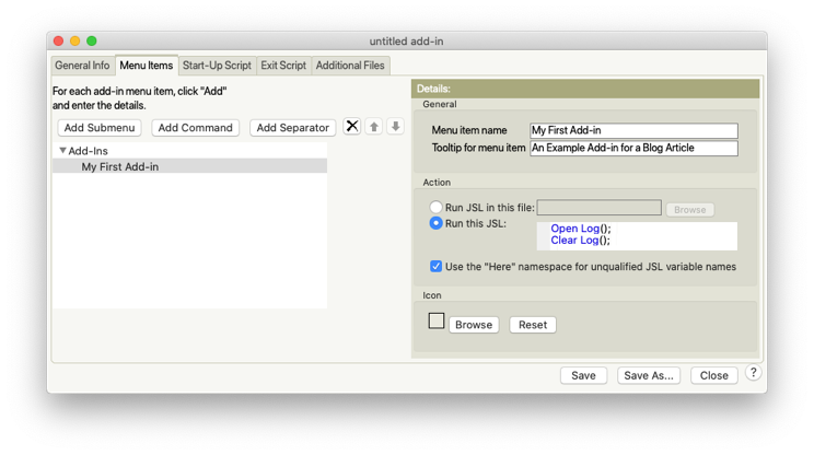

Under General Info, the Add-in Name and Version fields are pretty self-explanatory. You can limit legacy versions of JMP from running your code with the Minimum JMP Version. You can also limit your add-in to run on MacOS or Windows using the Host. I recommend setting the Minimum Version and Host to match the configuration of the system that the code was written on (unless you have the ability to test on other configurations). It’s easier than trying to make sure your code is bulletproof for all situations, particularly when you’re just starting out. The Add-in ID is a unique folder name that is created in the JMP file system when the add-in is installed. JMP recommends using the “Reverse DNS” naming convention (no idea why). It basically means you create something that looks like a website address and reverse it. For the add-in, we’ll use com.myAddin.MyFirstAddin. Here’s what the first tab should look like:
image085.pngimage085.pngUnder the Menu Items tab, you just need to click on the Add Command button. Then under Details, give the menu item a name. If you want to be fancy, you can give it a tool tip to explain what your add-in does when you hover over it. Then you just copy and paste your JSL into the Action area. If you’re using the code snippet above, your Menu Items tab should look like this:
And that’s it. Just save the file, and you’re done! Because the default action (on the General Info tab) is to install the add-in when you save it, clicking Save will both create a file to send around to others and install it on your own instance of JMP. Once you’ve saved the add-in, you should see an entry like this in your add-in’s menu:
