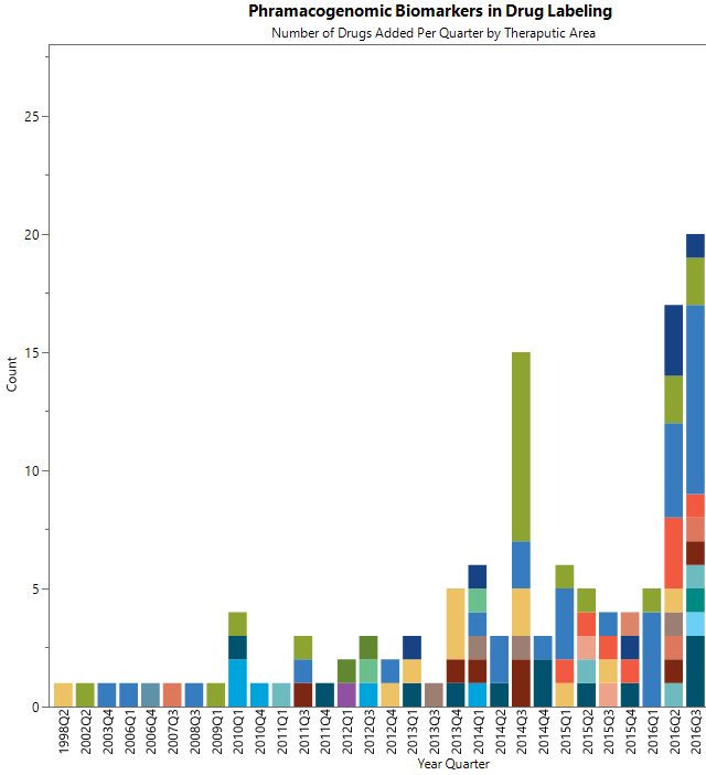

For these 10 tips, we are going to look at a recent report I published to JMP Public, which explores an interesting data set made available from the US Food and Drug Administration’s Center for Drug Evaluation and Research (CDER). Check out the report on JMP Public:
Biomarkers in Labels (CDER) | JMP Public
Source: Pharmacogenomic Biomarkers in Drug Labeling
View this at public.jmp.com >

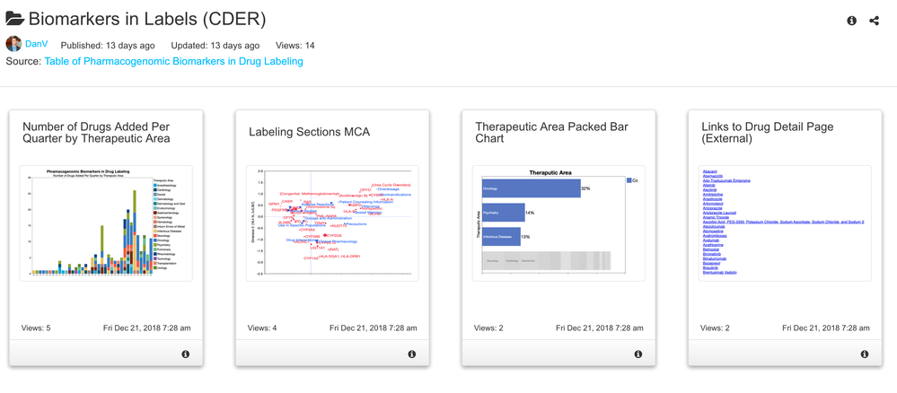

  10. Dashboards are great, but you don’t need to rely on them when publishing. When you publish multiple interactive HTML reports as a report collection to a JMP server, you automatically get a useful index page, which in many cases can serve the same purpose as a dashboard. Plus, you get the advantage of having a title and description for each individual report published to the collection if you want. And you are more forgiving of the various screen sizes that your consumers may have (phone, tablet, laptop etc.). PublishedReportIndexPage.png
