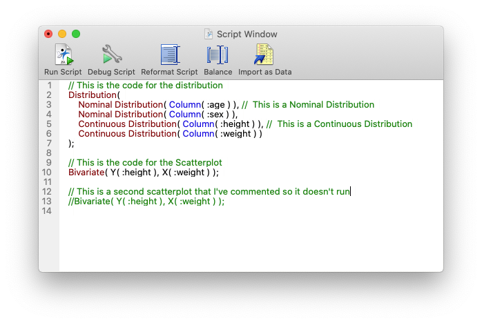

Let’s open up JMP and open that Big Class Families.jmp data table we’ve been using. If you didn’t save the script example from the last session, go ahead and recreate it. You should have something that looks like this:
There are two ways to put comments into your JSL code. The first is to comment out individual lines using a double forward slash ("//"). Anything after the slashes until a carriage return (hitting return on the keyboard) will be ignored. I generally use this method to do my short inline commenting. It’s also useful to turn off single lines of code that you don’t want to run. Let’s have a look at what that means:
The second way you can comment is used in cases where you want to turn off large blocks of code or to generate large blocks of comments and text. This type of comment is called a comment block. It’s done using an opening comment flag made of a forward slash and an asterisk ("/*") and a closing comment flag made of an asterisk and a forward slash ("*/"). Here’s an example of how this might be used:

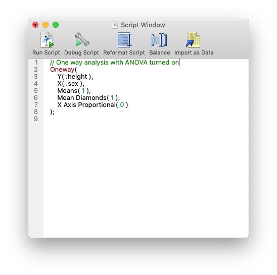

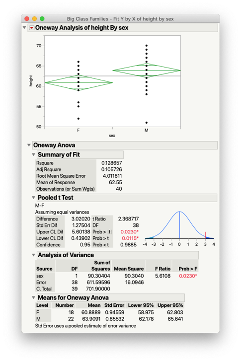

Let’s look at an example using an ANOVA. To create the code for an ANOVA, first run the analysis in Fit Y by X (under Analyze), then turn on the ANOVA test, and then save the code out to a script window. Here’s the report for that using Big Class Families.jmp and the resultant JSL code saved from the red triangle menu (height as Y, sex as X, and selecting Means/Anova/Pooled t under the red triangle) :
This little JSL snippet will produce an ANOVA for any data table that has the same column names as the original data table. (We’re not going to worry about parameterization in this series, though. It’s a bit out of scope.)

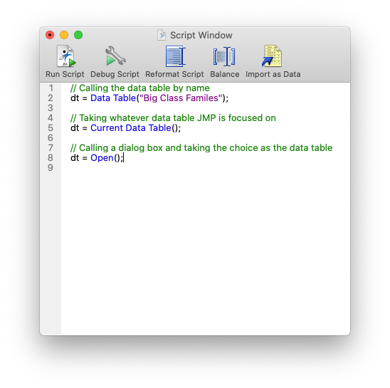

Now, what if you’ve got a bunch of data tables open and you want to control which data table you want to run that ANOVA on? Well, you can edit the script by giving a name to the data table you want to run the ANOVA on and then sending the JMP-generated code as a message. If you were to look in the Scripting Index (see the article on getting help), you would find a couple of ways to do this. You could either call a data table directly or grab a reference to the data table JMP is currently focused on by using Current Data Table(). There is a third option that’s a little more advanced, where you give a data table a name as you open it. I’ve put examples of all three below (and again note the use of comments to convey information!):
Calling the data table by name will work as long as there is a data table open that has the name you are trying to use. This can be handy if you have a list of data table names to work from. It can also be handy if you’ve hidden or minimized your data table. In either case, you can still send messages to the data table even if you can’t necessarily see it. This method uses the form:
<variable name> = Data Table(“<data table name>”);
Probably the most useful way to assign a variable to a data table for our purposes is to use the Current Data Table () function. This function grabs whatever is the active or current data table and assigns it to the variable that you’ve indicated. Once the table is assigned to the variable, it doesn’t matter if another data table becomes “current” (e.g., by creating a summary table, you’ll always have a reference to the first data table until you redefine the variable). It has a simpler form:
<variable name> = Current Data Table();

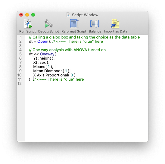

The last method is useful if you want to assume that the data table may not be open when someone runs the script. By using this method, JMP will generate a file dialog that allows the user to select the file they want to open. When the user confirms their choice, the file will be opened and assigned the variable name you’ve given it. Again, it’s a simple form:
<variable name> = Open();

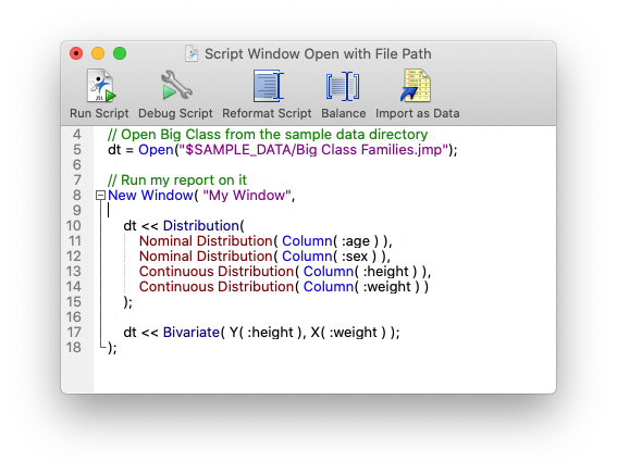

Using the Open(…); method can also be handy if you’re comfortable working file paths and directories. You can put the file path inside the parentheses to tell JMP where to look for the file, like this:
Also, note that I’m using something called a Path Variable in the Open(…); command to shorten the string. There’s a section on them in the Scripting Guide.

Okay, there are three last details that need to be addressed. The first is the issue of stringing things together. For instance, if you wanted to do an ANOVA and create a Graph Builder in the same script, you’d need to warn JMP that further instructions are to follow. To do this, use that Glue Operator (;) that I keep mentioning.
Like a semicolon in written English, the semicolon at the end of a command lets JMP know that there are more instructions to come. Glue is found at the end of an instruction like Bivariate(...);, or Distribution(...); , or giving something a name: stuff = 5 + 6;. As you may recall from earlier posts, JMP includes the semicolon automatically when we use Save Script…To Script Window, but when scripting freehand, this happens to be the most common error I commit during scripting – forgetting to glue things together.
