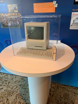

I was talking with my dad a few weeks back. Not to date him, but he’s been using JMP since version 1.0. I remember seeing the 3.5” discs sitting next to our Mac II-se when I was first learning to use a mouse. The same machine was on display at the 2019 Discovery Summit conference in Tucson, Arizona. Here’s a picture of it:
