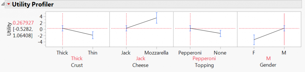

The Utility Profiler (just called “The Profiler” in JMP 11) can help explain how these interactions affect consumer choices. Selecting Utility Profiler from the red triangle menu brings up the following:
JMP_Utility_Profiler_1
Changing the Gender from M to F allows us to clearly see the effect of the interactions:
JMP_Utility_Profiler_2
Men are more likely to choose Thick crust pizza with Pepperoni. Women are more likely to choose Thick crust pizza with no toppings.
