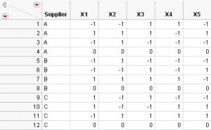

Imagine a setting where you have three suppliers and five continuous factors you want to investigate with a main effects model using 12 runs. You decide that you want three of the runs to be center runs. It turns out to be more statistically efficient not to have one center run for each supplier.
Table 1 displays the factor settings for the optimal allocation of center runs to suppliers.
Note that there are four runs for each of the three suppliers and that Supplier C has two center runs while Supplier B has none.

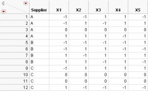

We can compare this design with the optimal nine-run design for the three suppliers with one center run added for each supplier. You can see this design in Table 2.
I feel more comfortable with the even allocation. What am I losing?
First, the maximum variance of prediction for the design is more than 50% bigger for the design with even allocation. Also, the average variance of prediction is more than 10% bigger.

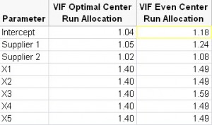

Figure 1 shows that estimated coefficients also have larger variances for the design that allocates the center runs evenly. For every parameter, the variance inflation factor (VIF) is larger for the design with even allocation of center runs.

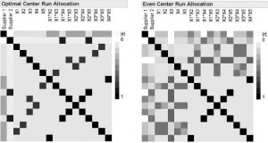

Figure 2 shows side-by-side plots comparing the column correlations for the two designs. The design for even allocation of center runs has messier and generally higher column correlations.
