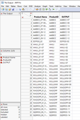

txnelson
Re: Parse string of a column and fill another column
Here is a script that produces a new table that expands the rows as requested.  By placing the data into a new table, it bypasses the issue where there are not a sufficient number of rows for the expansion.  It does appear to handle all of the known patterns.
Names Default To Here( 1 );
dt = Current Data Table();
dt2 = New Table( "The Output",
	New Column( "Product Name", character ),
	New Column( "ProductID", Character ),
	New Column( "OUTPUT", Character )
For( dtRow = 1, dtRow <= N Rows( dt ), dtRow++,
	If( dtRow == 1 | dt:ProductName[dtRow - 1] != dt:ProductName[dtRow],
		prodID = Word( 1, dt:ProductName[dtRow], "_" );
		remainder = Substr( dt:ProductName[dtRow], Length( prodID ) + 2 );
		While( Word( 1, remainder, "_" ) != "",
			theWord = Word( 1, remainder, "_" );
			If( Contains( theWord, "-" ),
				numDigets = Length( Word( 1, theWord, "-" ) ) - 1;
				zeros = Repeat( "0", numDigets );
				For( loop = Num( Word( 1, theWord, "-" ) ) + 1,
					loop <= Num( Word( 2, theWord, "-" ) ), loop++,
					dt2 << Add rows( 1 );
					theRow = N Rows( dt2 );
					dt2:ProductName[theRow] = dt:ProductName[dtRow];
					dt2:ProductID[theRow] = Word( 1, dt:ProductName[dtRow], "_-" );
					dt2:output[theRow] = dt2:ProductID[theRow] || "-" ||
					Substr( zeros, Length( Char( loop ) ) ) || Char( loop );
				dt2 << Add Rows( 1 );
				dt2:output[theRow] = prodID || "-" || Word( 1, theWord, "-" );
			remainder = Substr( remainder, Length( theWord ) + 2 );
Jim

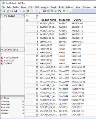

cchueng
Level IV
Thanks Jim but the OUTPUT appears to be incorrect. For example the first 3 lines, the OUTPUT should be :
AABBCC-07
AABBCC-08
AABBCC-13
txnelson
It just had a minor error where a -1 was not removed when I restructured my code.
				For( loop = Num( Word( 1, theWord, "-" ) ),
Please make sure you take the time to study the code, so you completely understand how it is working.
