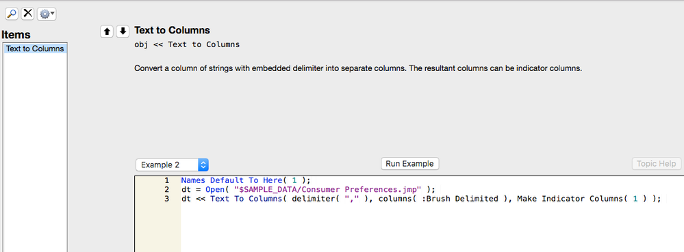

ian_jmp
Level X
Re: How can I split text in a column into multiple columns?
In my build of 13.1, I see:
Screen Shot 2017-05-03 at 15.03.50.pngScreen Shot 2017-05-03 at 15.03.27.png
pmroz
Thanks Ian.  I'm using JMP 13.1.0 and that page is blank.
