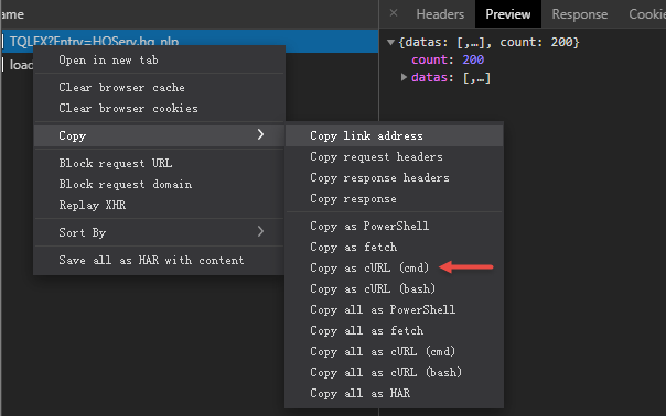

lwx228
Level VIII
Re: JMP-Tools Add-in overview - JMP addins written by jthi
Quickly convert browser copy to JSL code with EmEditor's replacement feature
CURL (CMD) is copied from the browser F12 and quickly converted to JSL code with the EmEditor replacement function.
Of course, this process should also be implemented with JSL.
cURL(cmd)
curl "http://excalc" -H "Connection: keep-alive" -H "Origin: http://excalc.icfqs.com:7616" -H "User-Agent: Mozilla/5.0 (Windows NT 6.1; WOW64) AppleWebKit/537.36 (KHTML, like Gecko) Chrome/78.0.3904.108 Safari/537.36" -H "Content-Type: text/plain" -H "Accept: */*" -H "Referer: http://excalc.icfqs.com:7616/site/tdx-zbfx/page-ddlj.html?setcode=1^&code=xxxxxx^&name=ssssss^&color=0" -H "Accept-Encoding: gzip, deflate" -H "Accept-Language: zh-CN,zh;q=0.9,en;q=0.8,zh-TW;q=0.7" -H "Cookie: ASPSessionID=" --data-binary "^[^{^\^"funcId^\^":2,^\^"offset^\^":0,^\^"count^\^":200,^\^"cond^\^":^\^"time,11700,33600^|amount,14^\^",^\^"modname^\^":^\^"TickAly^\^"^}^]" --compressed --insecure
