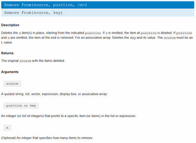

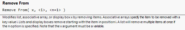

Quick example by using Remove From(), for starters the descriptions are different in Scripting Index and JSL Syntax Reference and JSL Syntax provides more information what the function does but lacks examples. Also the function descriptions are different in Scripting Index vs JSL Syntax Reference... and the functions should behave differently based on this?
Remove From( x, <i>, <n=1> ) vs Remove From(source, position, <n>),
First is saying that i and n are optional, but for some reason i has no default value (it seems to be -1).
Second one says that second argument is mandatory and n is optional with no default value.
Scripting Index (Remove From isn't supposed to return anything based on this?)
Online Syntax Reference has wrong information on Returns (it does return the removed items and modifies source in place).
