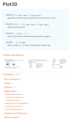

At the end we could get something like this:
 https://reference.wolfram.com/language/ref/Plot3D.html
A documentation with the spirit of:
Let's show the user everything that is possible with our program.
Not a single, tiny detail should be left un-explained.
  • examples with different levels of complexity
    starting with basic examples like
    Names Default To Here( 1 );
    ex = Expr( a + Sqrt( a ) );
    Substitute Into( ex, Expr( a ), Expr( b ) );
    Name Expr( ex );
    then explaining many possible applications (if possible: so many that even sub-categories are necessary :)
    and always ending at neat examples with examples which make you think:
    Woah, it's amazing that this is possible!
  • all options should be nicely listed (see: details and options)
    and the most important options should be presented with an individual example how they can be used (see: examples/options)

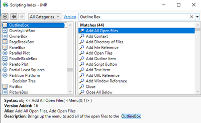

A general question concerning the usage of the Scripting Index:
Let's say:  I want to get some info about Outline Box from the Scripting Index.
When I search for Outline Box, the first step is that Outline Box shows up (2x) under Item Name matches in the list on the right:
When I click on the top entry, I see a short description of the Outline Box Constructor and a example how to generate one
(and there is a danger that I get trapped here).

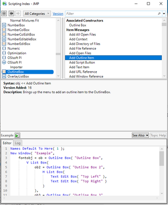

But more important: I notice that the Outline Box entry in the left list gets visible and marked grey (actually it was already marked grey before, but hidden further down in the scroll box).
Now I can click on Outline Box in the list on the left
and finally I just have to empty the search field and end up with
A nice overview of all details concerning the OutlineBox object,
first the constructor and then all all messages that can be sent to the object.
And for each message, one can see a nice example how it can be used *)
Is this the intended way to get here - there is also a faster way, right?

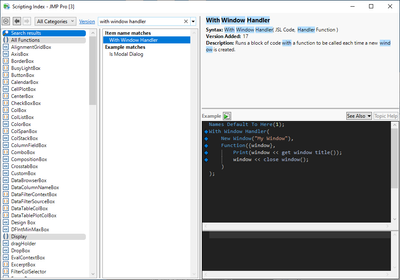

  3. Three new JSL built-in functions: With Window Handler(), Set Global Window Handler(), and Clear Global Window Handler()
  4. You can now script the font picker, most file picker dialogs, and simple host alerts (such as Yes/No and Yes/No/Cancel)
  5. New Window() now supports the creation of the following window types: Modal Dialog, Dialog, and Launcher.
    1. Why aren't Report, Journal and Script mentioned as those are also possible values for Type()?
Too bad I couldn't really find good examples for these or any explanation what these do. Scripting Index does have some but Scripting Guide and JSL Syntax seem to have nothing.
With Window Handler (no Topic Help available and not found from JSL Syntax Reference):

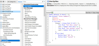

I just found an easteregg in the Scripting Index: Lineup Box
It provides a 1col  "grid" as a (very special but neat : ) example for Line Up Box :
Fortunately, the "official" Version of Line Up Box (notice the additional space) provides a more general example:
The only thing ...
When the user Alt double-clicks a LineupBox/Line up Box/Line Up Box in JSL Editor, JMP opens the easteregg - without link to the official entry ...
