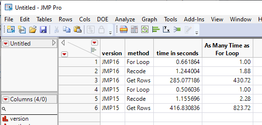

And here are the surprising results
The For Loop wins hands down.  And from the results, the Get Rows Where should be used sparingly.
Comments and corrections are welcomed......

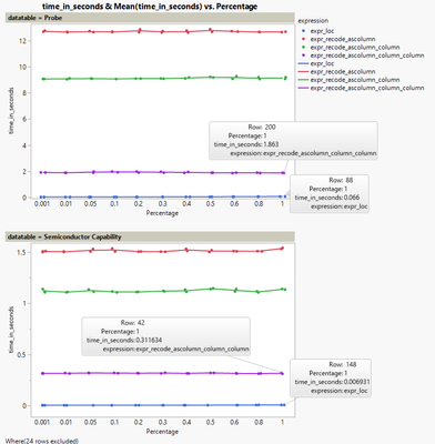

Went maybe a bit too deep on this (but at least got some kind of an idea how to do this type of testing later if I have to).
I wrote a some sort of testing script with different expressions to test different ways of replacing the 999 with missing. I tested with two datasets (Semiconductor Capability.jmp and Probe.jmp) and changing the amount of missing values in columns.
Loc() is fastest at replacing values (no surprise there). Missing Value Codes() is "always" fast but it has a bit more limited use cases when compared to Loc() and It is a bit more of a hassle to use if there would be multiple values to replace.
Fastest ended up being loc_2d (didn't bother changing variable names from this: Using Loc With a 2D Matrix ). Still have to loop to get values set (at least to my knowledge), so most likely the reason for this being faster than just Loc() is that it will skip some columns. Below are expr_loc2d and expr_loc:
expr_loc = Expr(
	for(i=5,i<= ncols(testData),i++,
		column(testData,i)[Loc(testData[0,i], 999)]=.;
expr_loc_2d = Expr(
	mat = testData[0,5::NCols(testData)];
	nr = N Rows(mat);
	nc = N Cols(mat);
	blacklocs = Loc(mat, 999) - 1;
	rowlocs = Floor((blacklocs) / nc ) + 1;
	collocs = Mod((blacklocs), nc ) + 1 + 4;
	uniqCols = Associative Array(collocs) << get keys;
	For(i_2d = 1, i_2d <= N Items(uniqCols), i_2d++,
		testData[rowlocs[Loc(collocs, uniqCols[i_2d])], uniqCols[i_2d]] = .;
Also it seems to be important to use AsColumn(Column(dt, i)) like @Ryan_Gilmore said (didn't even bother testing <<  get rows where without it, because it will be very slow), but I did test recode with and without Column(). Also just noticed that I missed one Column() from recode, so run couple of quick tests (not attached in data or script):
Fairly big difference between these three:
expr_recode_ascolumn = Expr(
	For(i = 5, i <= N Cols(testData), i++,
		testData << Recode Column(
			As Column(dt, i),
			{If( _rcNow == 999, ., _rcNow)},
			Target Column(As Column(testData, i))
expr_recode_ascolumn_column = Expr(
			As Column(dt, i),
			Target Column(As Column(Column(testData, i)))
expr_recode_ascolumn_column_column = Expr( For(i = 5, i <= N Cols(testData), i++, testData << Recode Column( As Column(Column(dt, i)), {If( _rcNow == 999, ., _rcNow)}, Target Column(As Column(Column(testData, i))) ) ); );
The test script and some result data attached. Script will mostly likely have some mistakes here and there. Should be fairly easy to add new expressions if someone wants to do so. One thing I didn't test at all is using << Begin/End data update.
