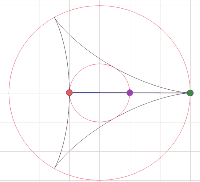

Just curious how to draw this motion picture in JSL.
AI writing JSL is still impossible to complete the implementation.

I fixed the Elements command - and got this plot:
Is this a suggestion how JSL should look in the future?
after fixing the arguments of the element function, the plot is generated and looks like this:
Seems that the AI misinterpreted your command.
One can see the "teardrop" which is mentioned in the comments - but it's not there in the input animation.

I just got this code from the AI,
I just gave this GIF to GPT-o1, it supports GIF reading, it writes JSL, but this JSL is not implemented.
grok3 does not support GIF, so I will GPT-o1 written JSL and the existing problems to grok3 to modify.
It was modified to get the JSL above.It doesn't live up to the look I gave the original GIF.
But I wouldn't change it at all.

intermediate step via Python:

lala
Level IX
Re: How to use JSL to realize the hanging valley dynamic graph?
Excellent work.
Can experts share this code?
Thank you very much!

second step: JSL

myCircle = Function( {t, r},
	{default local},
	x = r * Cos( t );
	y = r * Sin( t );
	Return( Eval List( {x, y} ) );
// Compute the tangent
compute_tangent = Function( {t0, r_inner, r_outer, a},
	{default local},
	point = deltoid( t0, r_inner, r_outer, a );
	x0 = point[1];
	y0 = point[2];
	h = 1e-5;
	dx_dt = deltoid( t0 + h, r_inner, r_outer, a )[1] - deltoid( t0, r_inner, r_outer, a )[1];
	dy_dt = deltoid( t0 + h, r_inner, r_outer, a )[2] - deltoid( t0, r_inner, r_outer, a )[2];
	slope = dy_dt / dx_dt;
	intercept = y0 - slope * x0;
	Return( Eval List( {x0, y0, slope, intercept} ) );
// Function to compute the distance between a point and a line
distance_to_line = Function( {point, slope, intercept},
	{default local},
	x = point[1];
	y = point[2];
	Return( Abs( slope * x - y + intercept ) / Sqrt( slope ^ 2 + 1 ) );
// Function to compute intersection points
find_closest_points = Function( {slope, intercept, splits},
	{default local},
    // Split the deltoid coordinates into three sections
	// Compute the minimum distance for each section
	min_distances = Transform Each( {split}, Eval List( splits ),
		Min( Transform Each( {point}, split, distance_to_line( point, slope, intercept ) ) )
	split_to_remove = Loc Min( Matrix( min_distances ) );
    // Select remaining valid sections
	valid_splits = Remove( Eval List( splits ), split_to_remove );
    // Find the closest point with the smallest distance
	closest_points = {};
	For Each( {split}, valid_splits,
		min_pos = Loc Min( Matrix( Transform Each( {point}, split, distance_to_line( point, slope, intercept ) ) ) );
		Insert Into( closest_points, split[min_pos] );
	Return( closest_points );
// Create a new table
dt = New Table( "Deltoid Data",
	Add Rows( 999 ),
// Create columns for the table
	New Column( "angle", Numeric ),
	New Column( "x_deltoid", Numeric ),
	New Column( "y_deltoid", Numeric ),
	New Column( "x_inner", Numeric ),
	New Column( "y_inner", Numeric ),
	New Column( "x_outer", Numeric ),
	New Column( "y_outer", Numeric ),
	New Column( "x_0", Numeric ),
	New Column( "y_0", Numeric ),
	New Column( "x_1", Numeric ),
	New Column( "y_1", Numeric ),
	New Column( "x_2", Numeric ),
	New Column( "y_2", Numeric ),
	New Column( "x_center", Numeric ),
	New Column( "y_center", Numeric )
angles = 2 * Pi() * (As List( Transpose( 1 :: 999 ) ) - 1) / 999;
dt[0, "angle"] = angles;
dt[0, {"x_deltoid", "y_deltoid"}] = deltoid_coordinates;
dt[0, {"x_inner", "y_inner"}] = Transform Each( {t}, angles, myCircle( t, r_inner ) );
dt[0, {"x_outer", "y_outer"}] = Transform Each( {t}, angles, myCircle( t, r_outer ) );
dt[0, {"x_0", "y_0"}] = Transform Each( {t}, angles, compute_tangent( t, r_inner, r_outer, a )[{1, 2}] );
dt[0, {"x_1", "y_1", "x_2", "y_2"}] = Transform Each( {t}, angles,
	{slope, intersect} = compute_tangent( t, r_inner, r_outer, a )[{3, 4}];
	find_closest_points( slope, intersect, splits );
dt[0, "x_center"] = (dt[0, "x_1"] + dt[0, "x_2"]) / 2;
dt[0, "y_center"] = (dt[0, "y_1"] + dt[0, "y_2"]) / 2;
::myrow = 1;
New Window( "deltoid",
	V List Box(
		gb = Graph Builder(
			Size( 466, 471 ),
			Show Control Panel( 0 ),
			Summary Statistic( "Median" ),
			Graph Spacing( 4 ),
			Variables(
				X( :x_0 ),
				X( :x_1, Position( 1 ) ),
				X( :x_center, Position( 1 ) ),
				X( :x_2, Position( 1 ) ),
				Y( :y_0 ),
				Y( :y_1, Position( 1 ) ),
				Y( :y_center, Position( 1 ) ),
				Y( :y_2, Position( 1 ) )
			Elements(
				Line(
					X( 1 ),
					X( 2 ),
					X( 4 ),
					Y( 1 ),
					Y( 2 ),
					Y( 4 ),
					Legend( 33 ),
					Ordering( "Within Row" ),
					Connection( "Arrow" ),
					Summary Statistic( "Mean" )
				Points( X( 1 ), Y( 1 ), Legend( 34 ) ),
				Points( X( 2 ), Y( 2 ), Legend( 35 ) ),
				Points( X( 4 ), Y( 4 ), Legend( 36 ) ),
				Points( X( 3 ), Y( 3 ), Legend( 37 ) )
			SendToReport(
				Dispatch( {}, {:x_0}, ScaleBox, {Min( -2.96728319980322 ), Max( 3.31428686472806 ), Inc( 1 ), Minor Ticks( 4 )} ),
				Dispatch( {}, {:y_0}, ScaleBox, {Min( -3.05132715458842 ), Max( 3.20702958989834 ), Inc( 1 ), Minor Ticks( 1 )} ),
				Dispatch( {}, "400", ScaleBox,
					{Legend Model( 34, Properties( 0, {Marker Size( 12 )}, Item ID( "y_0", 1 ) ) ), Legend Model(
						35,
						Properties( 0, {Marker Size( 12 )}, Item ID( "y_1", 1 ) )
					), Legend Model( 36, Properties( 0, {Marker Size( 12 )}, Item ID( "y_2", 1 ) ) ), Legend Model(
						37,
						Properties( 0, {Marker Size( 12 )}, Item ID( "y_center", 1 ) )
				Dispatch( {}, "Graph Builder", FrameBox,
					{Marker Drawing Mode( "Outlined" ), Reference Line Order( 3 ), Add Graphics Script(
						2,
						Description( "" ),
						Pen Color( "black" );
						Line( :x_deltoid << get values(), :y_deltoid << get values() );
						Pen Color( "red" );
						XY Function( Cos( x ), Sin( x ), x, Min( 0 ), Max( 2 * Pi() ), inc( 0.001 ) );
						XY Function( 3 * Cos( x ), 3 * Sin( x ), x, Min( 0 ), Max( 2 * Pi() ), inc( 0.001 ) );
						Pen Color( "blue" );
						Pen Size( 3 );
						Line( {:x_1[::myrow], :y_1[::myrow]}, {:x_2[::myrow], :y_2[::myrow]} );
ldf = gb << Local Data Filter( Add Filter( columns( :angle ), Modeling Type( :angle, Nominal ), Where( :angle == 0 ) ) );
f = Function( {a},
	::myrow = Try( (ldf << Get Filtered Rows())[1], 1 )
fch = ldf << make filter change handler( f );
