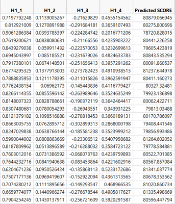

The columns of data created by the large dataset look like this...

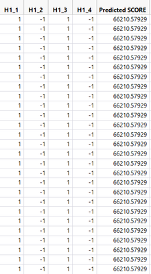

But when I copy the formulas into the smaller dataset then the results are broken...
I'm seem to be missing some sort of formatting or reference which is causing this error.  Any suggestions on how to port over the larger table's Neural Fit formula to the smaller table?

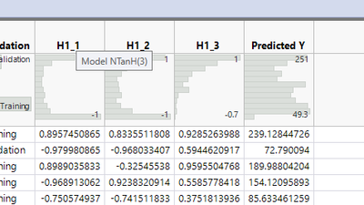

1. I creating the Neural fit by using the "Save Formulas" option (so I can get each node's formula).
2. This creates five formula columns (4 for the nodes, 1 for the final prediction).

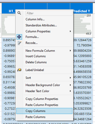

This will be easier option (if exclude scripting), use copy columns instead of copy column properties:
1. Save your formulas to table1
2. Select all the formula columns, right click and select copy columns
You will get script like this to your clipboard
View more...

3. Go to your second table, right click and Paste columns
Now you should have the columns correctly in your new table
