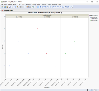

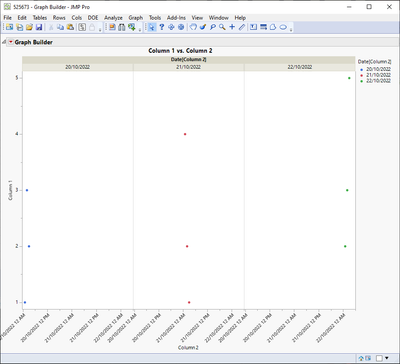

Group X could be what you want. Based on your description you may want  to use a Local Data Filter, found using the red triangle next to "Graph Builder" in the graph builder window, to exclude timestamps where data doesn't exist

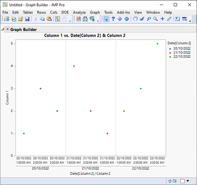

One option you could try setting your timestamp to Ordinal (or Nominal) and use your grouping variable as Overlay. You could possibly also add Date as additional grouping column
I have also attached data table with table script
-Jarmo

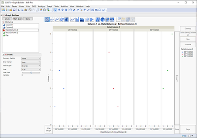

I think it could be a good wish list item that JMP would have an option to scale X-axis automatically where you are using X-grouping and have continuous X-axis. Currently JMP will just show "empty space". You cannot even scale them separately
This image might be easier to understand for some users to understand what is going on
After some paint and copy-paste of combining couple of graphs, something like this (should maybe work for nominal and ordinal x-axis too):
-Jarmo

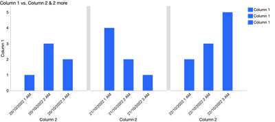

XanGregg
Staff
Re: How to insert X axis break in graph builder?
You might be interested in https://community.jmp.com/t5/JMP-Blog/How-to-create-an-axis-break-in-JMP/ba-p/30611, which shows another way to add an axis break: by adding a duplicate of the variable and adjusting each part to only show a fraction. Here's what it looks like on jthi's data, but changing the x variable (column 2) back to continuous:
I did some clean-up, changing the colors to all be the same, but would also want to edit the Legend Settings to hide the extra legend entries.
