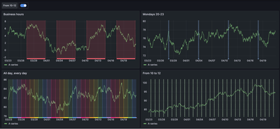

This functionality is a must for sensor data. For example, Grafana is now supporting this feature.
I can see this being built in graph-builder by default.
time-regions-in-time-series-panel-grafana-10.pngtime-regions-in-time-series-panel-grafana-10.png
https://grafana.com/blog/2023/06/13/grafana-10-release-all-the-new-features-to-know/

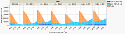

To restrict the time range like in Graphana ...
one can use a combination of X-Group and date/time wrap in JMP:
Input: Time series data
X-Group: day
Date/Time Wrap: Day
adjust the range:
in total:
(view in My Videos)

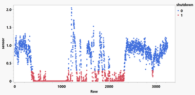

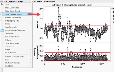

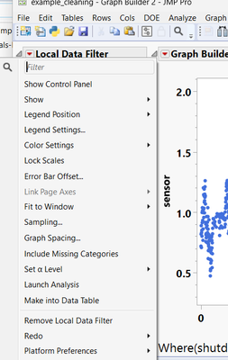

In manufacturing, we often encounter arbitrary events that should be excluded from visualizations. For example, periods when a specific measurement falls below a defined value, indicating that the equipment was out of service.
This is option possible under the Control Chart Builder, but not in graph builder.
hogi
Level XIII
FN
Level VI
Where is that option?

hogi
Level XIII

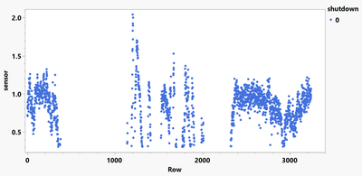

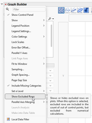

Hm, "Show Excluded rows" (a) works different from "Show excluded region" (b).
(a) is used to add excluded data points to a plot.
(b) is used to remove regions with no data from the x axis of a run chart.
(b) is now very easy in JMP19: create a virtual index column for the X axis via Col Rank(:row, @ Exclude, @Filter):
