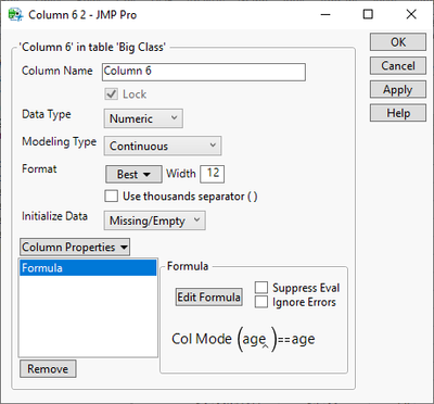

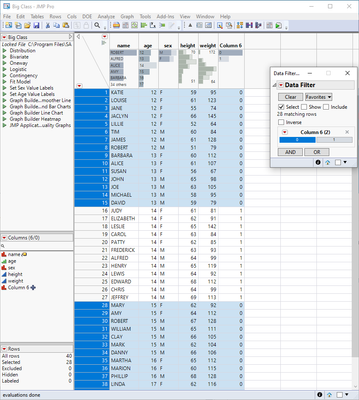

Create new formula column with your calculation. You could make it show 1 when it should be filtered and 0 when not. Then you can add Data Filter to your data table and use that as a filter.
Col Mode(:age) == :age

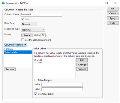

If you use If statement you can use character column with what ever text you want or Value Codes column property:
jthi_2-1675436125271.pngjthi_2-1675436125271.pngjthi_3-1675436135955.pngjthi_3-1675436135955.png

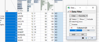

Another approach similar to that suggested by @jthi is to use a transform column within the data filter:
Define the formula just as you would when adding a column to the table:
The new column will appear only in the filter.  You can right-click to give the new column a different name, and then add it to the filter like any other column:
