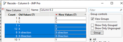

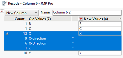

One option is to use Recode:
Select your values you wish to recode
Press Group
Select how you wish to recode them
And finally press Recode

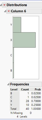

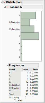

Changed this:
to this

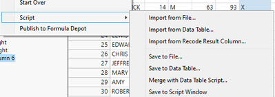

Or from Recode menu before you press Recode
