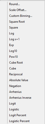

In the NewFormulaColumn/Transform menu there are many useful functions, but "modulo" is missing:

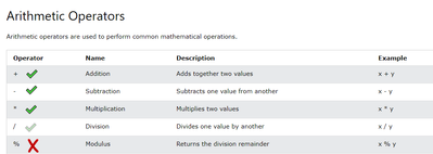

Nevertheless, every basic arithmetic operator should already be in the list by default - if necessary: in a submenu. The majority is there **).
Division is not directly available - but indirectly via Scale Offset/Multiplier. So, no issue.
But  modulo is completely missing.
Concerning importance:
For C++ the modulo operator was important enough to reserve a character for it. ***)
So, it's definitely not one of those strange functions which you hear and forget - and never use.

Single character arithmetic operators in C++:

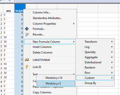

@hogi you can define custom functions that are available in the right-click New Formula Column menu:
Add Custom Functions(
	New Custom Function(
		"Modulo",
		"y=5",
		Function( {x}, Modulo(x, 5) ),
		<<Transform Category( 1 )
		"Modulo",
		"y=10",
		Function( {x}, Modulo(x, 10) ),
This adds:
