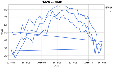

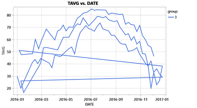

For Line Graphs in Graph Builder, there is a cool feature row order.
If it's selected, the line doesn't connect data points from left to right in the graph - but along the order in which they appear in the data table.
Instead of this graph:
the user gets this graph:
Much better ...
But unfortunately, there are those nasty jumps "back" to the next curve.
Of course, for simple graphs, you can use a column (here "Station") as an overlay to produce 3 separate curves, without the zigzag.
But already with slightly more complicated graphs like this one here: Graph Builder. Combine Smoother and Line - how? the user reaches the limits of current Graph Builder (v17, v18).

Another work-around, in case it's useful. Assigning the backwards line segments their own legend color item with width 0.
dt = Open( "$SAMPLE_DATA/Functional Data/Weekly Weather Data.jmp" );
dt << New Column( "group", Character, "Nominal", Formula( Substr( :STATION, 8, 1 ) ) );
dt << New Column( "cgroup", Character, "Nominal",
	Formula( If( Row() == 1 | Lag( :DATE ) > :DATE, "break", Substr( :STATION, 8, 1 ) ) )
Graph Builder(
	Size( 523, 448 ),
	Summary Statistic( "Median" ),
	Graph Spacing( 4 ),
	Variables( X( :DATE ), Y( :TAVG ), Overlay( :group, Overlay Encoding( "None" ) ), Color( :cgroup ) ),
	Elements( Line( X, Y, Legend( 31 ), Row order( 1 ) ) ),
	Local Data Filter(
		Add Filter( columns( :STATION ),
			Where(
				:STATION == {"USW00012924", "USW00013733", "USW00013877", "USW00014751", "USW00014922", "USW00024024"}
			Display( :STATION, N Items( 15 ) )
	SendToReport(
		Dispatch( {}, "400", ScaleBox,
			{Legend Model( 31, Properties( 3, {Line Width( 0 )}, Item ID( "break", 1 ) ) )}
		Dispatch( {}, "400", LegendBox, {Legend Position( {31, [0, 1, 2, -1, -4, -4, -4]} )} )
