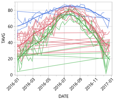

For Line Graphs in Graph Builder, there is a cool feature row order.
If it's selected, the line doesn't connect data points from left to right in the graph - but along the order in which they appear in the data table.
Instead of this graph:
the user gets this graph:
Much better ...
But unfortunately, there are those nasty jumps "back" to the next curve.
Of course, for simple graphs, you can use a column (here "Station") as an overlay to produce 3 separate curves, without the zigzag.
But already with slightly more complicated graphs like this one here: Graph Builder. Combine Smoother and Line - how? the user reaches the limits of current Graph Builder (v17, v18).
What is the improvement you would like to see?
  1.  With sorted data in the data table, a step from right to left indicates a new curve.
    So, with row order enabled, there could be an additional option to draw lines  "only left -> right".
    If this option is enabled, line for steps from higher to lower values will disappear -> the jump back-lines are gone : )
  2. Fallback:  Rows with missing y value could be used to add a break in line graphs (even somewhere in the center of the graph - cool, right?)

Regarding skipping backwards line segment connections, there is a new JMP 19 Ordering option in the Line element called "Row Ascending" which addresses the issue for cases like this.

Hello! This feature will be available in JMP 20. In Graph Builder, row order breaks have been added for grouped spaghetti lines. If you’re an authorized JMP user, you can try it now in JMP 20 EA 1. You can request access to the program by visiting JMP.com/earlyadopter.
hogi
Level XIII
Works great -  many, many thanks!
With the new option row ascending,
dt =Open( "$SAMPLE_DATA/Functional Data/Weekly Weather Data.jmp" );
dt << New Column( "group",Character,"Nominal",Formula( Substr( :STATION, 8, 1 ) ));
Graph Builder(
	Variables( X( :DATE ), Y( :TAVG ), Overlay( :group ) ),
	Elements( Line( X, Y, Ordering( "Row Ascending" ) ) )
 JMP can now produce this graph :
instead of this one:
