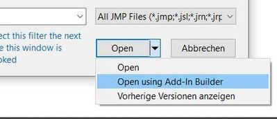

    @Georg:  You can open Add-ins in JMP as well
