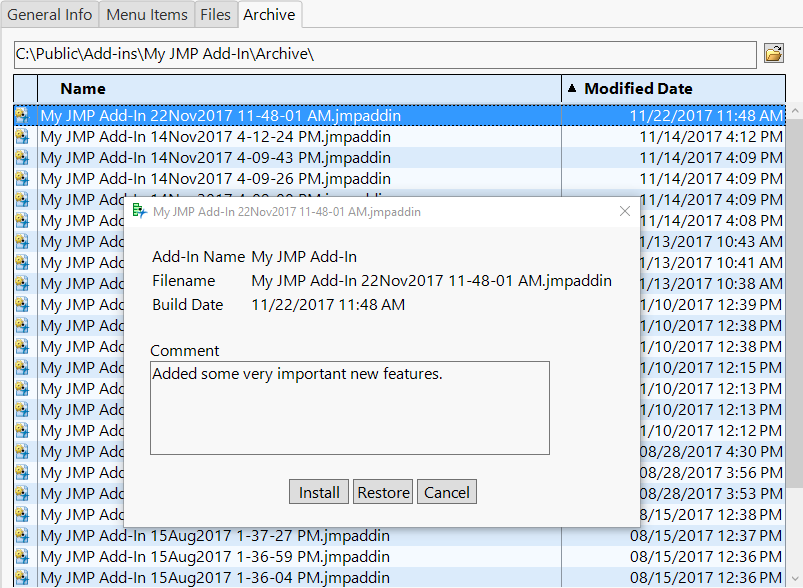

Manage Versions of an Add-In
Add-In Manager has the ability to automatically keep a version history of an add-in file each time a new one is built. It allows you to install, restore, or delete a previous version of an add-in. You can optionally include a comment for each build so you can keep track of what changes went into each version.

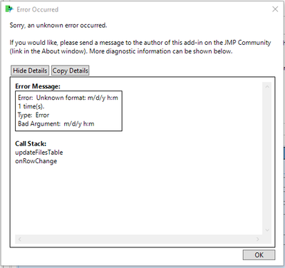

In JMP 14.0.1, I keep getting this error:
Error Message: {"argument should be list"(1, 2, "Concat Items", Concat Items /*###*/(errorList, " "))} Error: argument should be list 1 time(s). Type: Error Function Name: Concat Items Function being executed: Concat Items /*###*/(errorList, " ") Call Stack: getLastModifiedDateOfNewestFile getStatusIcon refreshAddinTableBox initialize
Any ideas? This is Manager 2.2.
John

@john_madden,
Thanks for reporting this! It looks like you are using a Mac, and you must have renamed or deleted one of your source folders. I have added a check for this now (v2.3) so it should not fail anymore.

Justin,
Version 2.3 works like a charm on my Mac! Thank you!!!
John

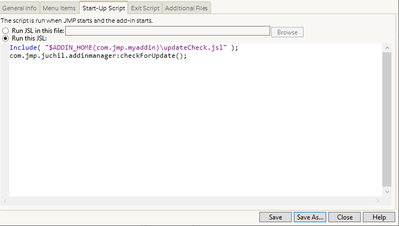

Adam_R
Hello Justin,
Add-In Manager v2.3 is working wonderfully in all aspects for me but one, I am unable to get the updateCheck to correctly push updates.  Some facts:
- My code outside of the update check runs correctly.
- My PROD folders "Metadata" and "Deployment" are both on server locations under the same parent folder, and I have verified users have access to them both.
- Within the Preferences section, I have selected "Include Update Check Script", and copied the include statement provided in this section into my code.  I have edited the add-in ID section of this statement from (com.jmp.myaddin) to match my add-in.  I did not edit anything else within this statement and did not edit anything within the updateCheck.jsl script.
- When making changes to the add-in and deploying to PROD, I have verified that the "pubDate" within the publishedAddins.jsl file located in the Metadata server file has changed with each deployment
- I have had users download an existing version of the file located within the PROD folder, close JMP, reopen JMP, and run the add-in with success.
- I have deployed a newer iteration to PROD, verified the pubDate changed, and requested the previous user to reopen JMP and run the existing add-in.  The user is never prompted to update the add-in.
- I have had the same user go into the PROD folder and reinstall the add-in, which has successfully updated the Add-In.
Justin_Chilton
Hi @Adam_R,
Thanks for all the work on the details! A few questions and things to try:
  • Do you have the "Create Metadata File" preference set under the "Custom Metadata" preference group? This file is required for the update script to pass.
  • What is the directory structure like for your addin? Is the script calling 'com.jmp.juchil.addinmanager:checkForUpdate' in a lower level folder? If so, the updateCheck.jsl file is expecting it to be in the same folder where the folder is being called from, making the function not work. A workaround for this is to add another JSL file at the root level of your addin (same as customMetadata.jsl and updateCheck.jsl) that calls the updateCheck function and just include that file in the lower level JSL script. Another option is to edit the updateCheck.jsl script to use '$addin_home(com.jmp.myaddin)/customMetadata.jsl' instead of just the relative file name. If this is the issue, I can update the addin to make this more flexible where it's not so dependent on the default directory of where you call the function.
  • The updateCheck.jsl script is implemented so it fails silently using a Try() so to not mess with the workflow of your add-in. So, if neither of the first two suggestions fix it, could you comment out the Try() within the updateCheck.jsl file and let me know what error message you get when you attempt to check for an update?
Let me know if you have any questions.
Regards,
Justin
Adam_R
Hello Justin,
As this is my first Add-In and I am an infant in regards to JMP experience (around 11 months of use), I may begin asking simple questions now as I work through activating the update-check function.  I have created a simple test add-in to focus on only the update function so I can understand this functionality before applying it to my more robust program.
THE SCRIPT:
aa = Include( "$ADDIN_HOME(com.jmpTest.myjmpaddin)\customMetadata.jsl" );
Include( "$ADDIN_HOME(com.jmpTest.myjmpaddin)\updateCheck.jsl" );
com.jmp.juchil.addinmanager:checkForUpdate();
New Window ("Test 3",
     Panel Box ("Test 3",
          Text Box("Test 3")
Responding to your questions:
  • Did I have the "Create Metadata File" preference set?
    • I did have the checkbox selected for "Create Metadata File", but I did not have the custom metadata code containing the include statement within my script.  I have added this line of code to the row immediately before the update check code as you can see above, but it did not correct the issue.
  • What is the directory structure of my addin?
    • In the middle section of the Add-In Manager window, Under the Files tab, addin.def, addin.jmpcust, customMetadata.jsl, and updateCheck.jsl all exist within the same folder.  That folder exists in the same parent folder as the addin file itself (<Filename>.jmpaddin).
      • This folder exists on my C drive, NOT on the server.  Should I have saved these files to the server as well?
    • In the bottom section, Prod tab, I have all three options saving to a server location.  They each have their own folder, and all three folders exist within the same parent folder.
      • ARCHIVE – only contains previous iterations of the add-in as I deploy.
      • META – only contains the file publishedAddins.jsl
      • PROD – only contains the add-in installer file .jmpaddin
  • What error message do I receive when commenting out “Try()”
    • I receive the error message “Error with file:  Path is invalid:  \customMetadata.jsl”
      • I have tried changing the above location path from the $ADDIN_HOME... language to the exact location on my C drive as it is called out in the File tab (middle section).  It did not help, I received the same error message.
Thank you for your assistance!
-Adam
Justin_Chilton
Hi Adam,
Appologies for the delayed reply. Based on the error message you are seeing when removing the try, it looks like my assumption about the updateCheck script being able to find the customMetadata file was correct. I see where you have the '
aa = Include( "$ADDIN_HOME(com.jmpTest.myjmpaddin)\customMetadata.jsl" );' part of your script. However, you don't actually need to include the file there. Instead, you want to change the include within the updateCheck.jsl script. It should look something like the following (around line 11).
customMetadata_aa = Include( "$ADDIN_HOME(com.jmpTest.myjmpaddin)\customMetadata.jsl" );
Let me know if you have any additional questions.
Regards,
Justin

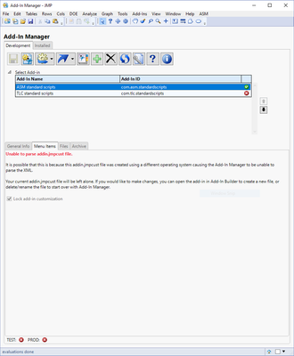

derekc
Hi there, I have started using Add-In manager after many years of managing changes manually. However, I recently had an issue with the Menu items not being visible I updated to JMP 14.3.0 recently, not sure if this is related. I had no issues with this before.
As you can see there are no errors in the build or deployment flagged so I'm at a loss as to what is happening.
Any help or suggestions are appreciated as I really don't want to have to rebuild it from scratch.
