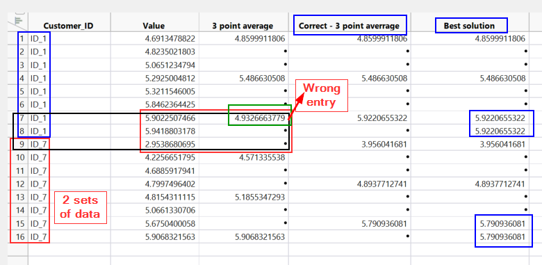

Hi All,
I am looking for  'n' row average (in the attached example, n == 3) based on other coulmn (-- "Customer_ID"). If my row number for each group (customer) is integer multiplier of 'n' i.e. [Row == Integer Constant x n]. My basic formula works fine. But if Row != Integer Constant x n, it takes remaining rows from other group. Which is giving me wrong results.
What I want -
Best Case - Calculate 'n' row average on sort of subset of the data based on Cutomer_ID and for the last remaining rows put the average value from previous averaged value.
Otherwise - leave the empty values as it is.
I tried to put   :Customer_ID != Lag(:Customer_ID, -2) but it did not work for me. I can split the table on Customer_ID and then do the calculation but - there are more than 5000 ID and around 20 columns for average to be done. It doesn't seems the best idea !
Any help please ?
Thanks.

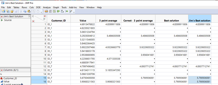

jthi
Re: 'n' row average of a column based on a condition from other column -

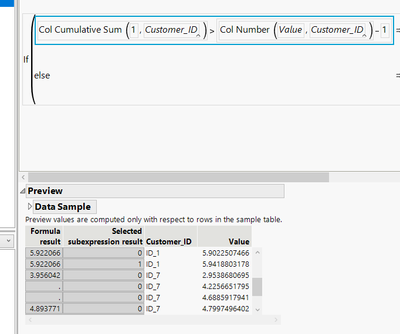

No idea if this will work in all cases, but it does work with the provided example data:
If(Col Cumulative Sum(1, :Customer_ID) > Col Number(:Value, :Customer_ID) - 1,
	Lag(Col Moving Average(:Value, 1, 0, 2, 0, :Customer_ID), 1),
	If(Modulo(Col Cumulative Sum(1, :Customer_ID), 3) == 1,
Check what each of the functions/formulas do from scripting index / scripting guide while checking selected subexpression result from formula editor to understand what it is doing as it is quite messy:
