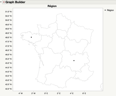

Hello,
I have a graph with map role describing regions, and I would like to add points with the exact coordinates X and Y of these points.
By default, the points are in the center of the regions (see file attached).
Many thanks for your help !

The saved script in your table gives:
I 'think' you are asking to put a dot in the middle of each region. If so, then that's possible since the shape file that defines each region is available if you know where to look. Of course the answer will depend on what, exactly, you mean by 'middle' You could simply take the mean of all the x values and of all the y values to get the requisite (x, y) location, but for better approaches see, for example here.
