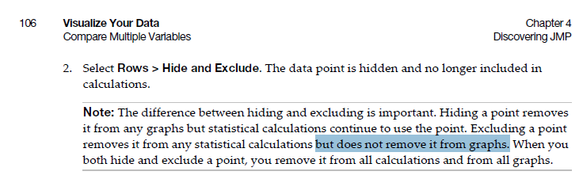

*) JMP Documentation:
https://community.jmp.com/t5/Learning-Library/Hiding-and-Excluding-Data/ta-p/271761

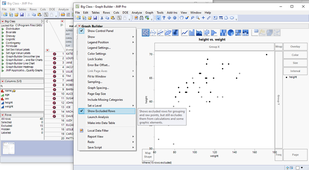

jthi
Re: exclude, but not "hide"
At least in graph builder there is a hidden... option (hold shift while you press the red triangle) Show Excluded Rows. With this enabled you will see excluded rows with slightly different transparency

Jasean
Staff
Different platforms interpret row exclusion differently.  In Graph Builder, when you exclude a row, it does not show as a Points element.  However, you can create the same graph in Fit Y by X.  In that platform, excluded points are shown, but they are not used in the line fit.  You would need to explicitly hide the point to remove it from the Fit Y by X graph.
