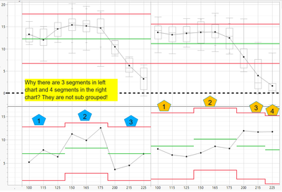

See question in the above chart. How does the number of segments defined please? Thanks!
Re: Question on JMP Means & R chart please
In the XBar & R chart of Error script attached to your data table, you will see that Target has been defined as the subgroup variable (Subgroup( :Target )).  For Target =100 and Name=A, there are 9 observations in the subgroup.  For Target=150 and Name=A, there are 18 observations in the subgroup.  The control limits vary because of the varying subgroup sizes.

Many thanks!  I also wonder how it is so, because I didn´t made any subgroup, and I don´t want. I just would like to understand how the 3 and 4 segments are generated automatically. since I need to explain the to people on the resulted plot. In my eyes, the number of the segments should be equal to the number of the x points. correct? or the number of the segments can be set with JMP? no idea.

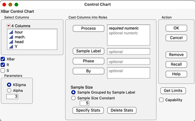

What version JMP are you running? What platform are you running?  If you could share your data set, perhaps we could provide some guidance.  You are running some sort of control chart platform, but there are multiple ways to create these charts.  If you choose Analyze>Quality and Process>Legacy Control Charts>Xbar, you will get the following screen:
In the Sample Size section, you have 2 options either Sample Grouped by Sample Label (by one of your columns) or select Sample Size Constant and enter the number of observations in a subgroup.  If you chose the first option, then subgroups may have unequal values within subgroup and therefore you may get varying control limits. Subgroups should be based on rational hypotheses.

Good to know there is such options. I used the control chart builder. Here I attach the data. Hopefully it would make it easier to have the problem explained. Many thanks!!
