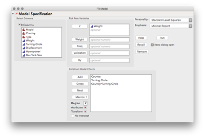

First I will fit a model like you're working with. I predict Weight on the basis of Country and Turning circle, and their interaction.
