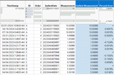

I have some data that I would like to calculate the % Error between the first and all subsequent measurements for each unique ID. I haven't been able to figure out how to get data from one cell based on values from other rows-columns. Does this require JSL, or if I can just create a formula as I've done in Excel.
I'd like the 2 columns that I've highlighted to be calculated using a formula, but with thousands of rows of data in the actual set, I could understand if it has to be a script and the values static until the script is run again.

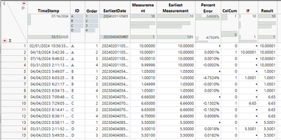

There are quite a few different options but they can be a bit difficult to understand. "Simplest" idea is to combine Col statistical function with if statement and if statement returns either missing or the value you are looking for.
Col Min(If(Col Cumulative Sum(1, :ID) == 2, :Measurement, .), :ID)
Benefit of using Col statistical functions is that they work well with grouping columns and as formulas.

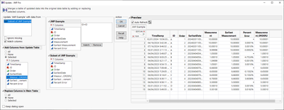

The method I would consider most "JMP like" is interactive solution and letting JMP create automated process (using enhanced log / workflow builder) and then fixing "issues" left by JMP created script:

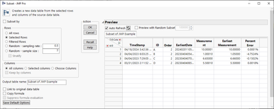

As you already have Order column which I assume you can use, create a subset of just Order == 2. Right click -> select matching cells -> make subset
From the subset rename Measurement column to something else. Then go back to your original table and use Update to join the subset back to your table using ID as the match condition column
and now you have your measurement from order two in a column. And JMP will write you a script like this:

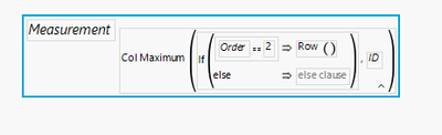

Along the lines of what @txnelson suggested, you could use this as well:
:Measurement[Col Maximum( If( :Order == 2, Row() ), :ID )]
This would return the second measurement for each ID.

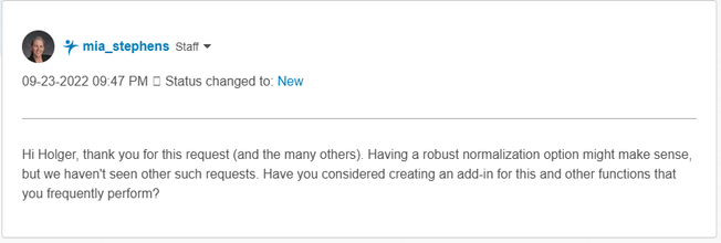

There is a Wish in the Wish List New Formula column/ Distributional: "Normalize" .
but the interest from other users is quite low - just 2 Kudos ...
So, I followed @mia_stephens advice
... and developed my own AddIn. It can be found in the Marketplace:

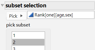

It is also possible to use the second entry for the normalization.
Just activate
and use a Rank/Order column like explained by @shampton82 :
