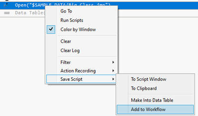

I was going to ask if it is even possible to send scripts to workflow's history but I think JMP provided me an answer by crashing (or rather just closing).
  1. Open Workflow Builder, Enhanced Log and Script window (no embedded log).
  2. Run simple script such as Open("$SAMPLE_DATA/Big Class.jmp")
  3. Add it to workflow
  5. JMP will close/crash
Using Windows 10 with JMP17 Pro.
-Jarmo
jules
Re: Workflow Builder + Add-Ins
Same behavior on the Mac, I just submitted it as a defect so we can get that fixed. Thanks for catching that!

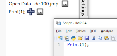

Hi @jules.
I noticed in JMP18: the execution of scripts gets recorded now. This is great.
Unfortunately, triggering an AddIn /  command via the Main Menu isn't recorded by default.
Where can I enable it.
jules
Hi @hogi,
That's correct, menu items selected interactively are not captured by action recording/workflow builder, and so interactively selecting a menu item created by an Add-In also won't get recorded. You could create that step manually in WFB using MainMenu("menu item name"). I certainly recognize the value if it were captured automatically, so we can explore this, but it's important to know that because of the way action recording is done internally it's not as easy as just "enabling" the recording of a menu selection.
