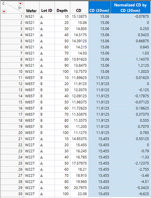

I'd like to find a value on a 'CD' column based on 'Depth' value, for corresponding 'Wafer' and 'Lot ID'.
Below is the example table I created, I have multiple 'CD' values at different 'Depth' values, and there are multiple 'Wafer' and 'Lot ID' for each specific wafers. What I need to find is 'CD' value at 20nm 'Depth', to create normalized CD plot.
I know I can use 'Col Mean' if I am to normalize by the column average. How do I normalize by CD at specific depth in this case?
Below highlighted portion is what I pasted manually...just to give an example of what I want.
Thanks

The formula would be
col mean( If( :depth == 20,:CD,.), :Wafer, :Lot ID)
Since only 1 row will be found to have :Depth=20, Col Mean() could also be substituted with Col Sum() etc.
One could also subset all of the Depth=20 rows into a new data table, and then Change in the subsetted data table the column CD columns name to CD(20 mm) and then using
     Tables=>Update
join the subsetted data back into the original data table, matching on Wafer and Lot ID
Jim
